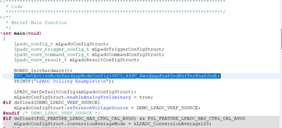

Hello @Weber1
Thanks for your patience.
The bandgap should be enabled before use.
You can use the function SPC_SetActiveModeBandgapModeConfig(SPC0, kSPC_BandgapEnabledBufferEnabled);
It is working fine now.
Alice

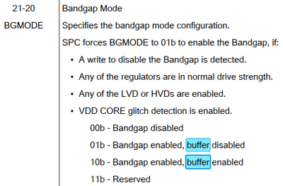

Weber1
Hi Alice,
this works perfectly fine! Thank you!
Seems to be my fault, which was not obvious to me from the manual. But it's not very obvious, I'd say.
By the way: Any ideas what's the bandgap buffer? (BGMODE=10b - Bandgap enabled, buffer enabled)

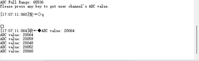

Weber1
Hi Alice,
thank you for your efforts. Getting a value of 0 seems also wrong, because expecting 1V of bandgap voltage.
My results are like this:
The HW setup is as simple as it can be: Windows-laptop -> USB -> FRDM-MCXA156 board -> (nothing else connected)
Any further ideas? Maybe anybody else used the bandgap voltage measurement with or without success?

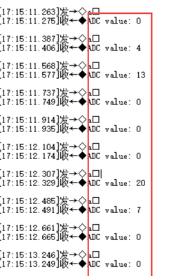

Hi @Weber1
Yes, it’s also incorrect on my side. All zeros even use your project.
I will investigate it deeply and confirm with internal teams.
Sorry for the inconvenience caused.
I’ll keep you updated with any progress.
Thank you.

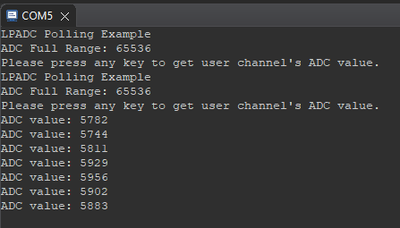

Weber1
thank you for the quick reply. Yes, I'm using the FRDM-MCXA156 board and just imported the lpadc_polling example and made a few changes like
#define DEMO_LPADC_BASE ADC0
#define DEMO_LPADC_USER_CHANNEL 27
With this, I'm getting values around 5900 at high-resolution, which indicates that bandgap voltage is 0.3V.
Find attached the project files.
Weber

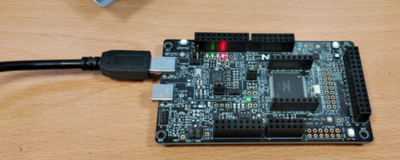

Hello @Weber1
I have tested your project on my side, but I always get almost 0 every time. I am using the FRDM-MCXA156 board.
Could you please share a photo of your hardware connections, as well as the test results from your side?
Thank you.
