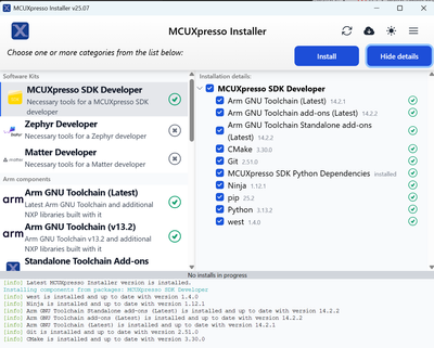

carlos_o
Hi @brucebowling
Did you restart your computer after the MCUXpresso installer finish to install the SDK Developer kit?
It needs to show something like the following when you try to add a new repository
In my end there is also in the list matter and zephyr repositories because I have the corresponding developer kits.
The MCX E family is already on the SDK repositories for VS Code MCUXpresso but the page is not updated yet. The link I previously share is for download the SDK to use it with the MCUXpresso IDE not with VS Code.
3,086件の閲覧回数
brucebowling
OK, mine looks a little different:
And when I try to Import Example from Repository, the FRDM MCXE does not appear in the list of choices. Other FRDM boards show, but nothing for MCXE family.
I was not given a choice to select the Revision V25.06.00 when I installed the SDK, I believe this is the issue?

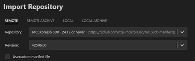

carlos_o
Hi @brucebowling
Thanks for your post.
Once you have MCUXpresso for VS Code and install the software kits with the MCUXpresso Installer you need to import a repository, for the MCXE247 add the MCUXpresso SDK - 24.12 or newer and select the revision v25.06.00
Use the name and location you prefer.
Once the process ends and you have added the repository you could import the examples from repository
If you want to download the SDK for the MCUXpresso IDE you could do it from MCUXpresso SDK Builder
Let me know if you have more questions.
