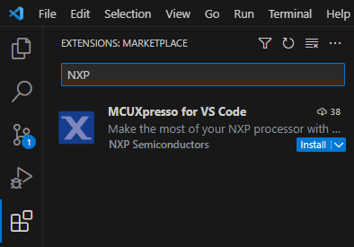

  • Launch Visual Studio Code
  • Click the Marketplace icon found in the main left navigation pane
  • Search "NXP" in Marketplace search bar.  Click "MCUXpresso for VS Code"
  • Click Install in the MCUXpresso for VS Code extension.  Installation includes other required extensions (i.e. C/C++ by Microsoft)

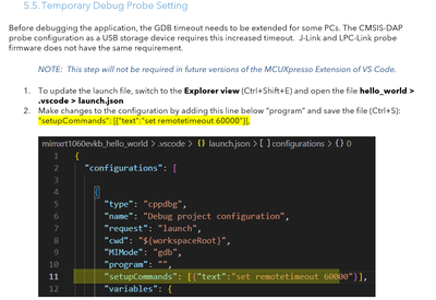

I have just installed the Toolchain and try to run a the provided Hello World Programm on a IMXRT1050-EVKB Board. I can compile the programm but when connecting to the Board to Debug the result, I get an GDB Error Message saying that the connection can not be established. Is there anything that I still need to set up in order for the debug process to run ?
If the i.MX RT1050-EVKB board shows up in your Windows (assumed) explorer as a USB device, then the debug settings require a latency setting.  This is being added to the extension release next week.
YOu can manually see if this fixes the issue where debug data is not reliable due to GDB server latency/timeouts.
Open the launch.json file for the project.
Paste the following command as shown in the image below:
"setupCommands": [{"text":"set remotetimeout 60000"}],
Note 1: you should also verify that you installed the LInkserver Debug Probe software in the installer.  The Linkserver software is used with the probe on the board.  HOwever, not having this software installed usually reports an error of missing software.
Note 2: you should also verify that the board has core power.  Without the board showing up as a USB storage device indicates it is using J-Link or LPCLink debug firmware.  This can require 2 usb cables to provide power to the board if an external power supply is not connected to the barrel connector.  The USB cables should connect to the Debug USB port and the USB Device port.  Refer to the RT1050-EVK getting started page to verify you have power.
Note 3: You may also verify that it connects with MCUXpresso IDE to eliminate VS Code as the issue.
Please let us know if this helped with your issue.
Hi and thank you for your response. I was able to get the  i.MX RT1050-EVKB Board running and am also now able to compile and Debug SW for the Board. I had to select one of the following confiugrations : flexspi_nor_sdram_debug / flexspi_nor_sdram_release
