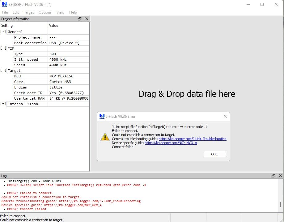

I am trying to use a Segger J-Link JTAG with the FRDM-MCXA156, and no matter the jumper configuration I am unable to get the Segger tools to connect to the processor.  Lotest Segger tools installed, J-Link firmware updated to latest version.
Ultimately I plan to use IAR tools with the Segger J-Link, but for now, I am just trying to get the J-Link to work.  Any suggestions are welcome.
When I try to connect to the processor using J-Link Commander V9.36, it goes through the motions, but fails with :
****** Error: J-Link script file function InitTarget() returned with error code -1
Error occurred: Could not connect to the target device.
For troubleshooting steps visit: https://kb.segger.com/J-Link_Troubleshooting
J-Link>

Sadly, not what I am seeing with J-Flash.  I had configured my board with the jumpers in the same way as you have yours.  I tried both SWD and JTAG, all I get is an error when trying to connect to the processor.  I tried two different J-Link devices with two different 10 pin adapters.

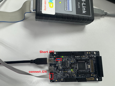

Hello @rjrapier ,
Thanks for your post.

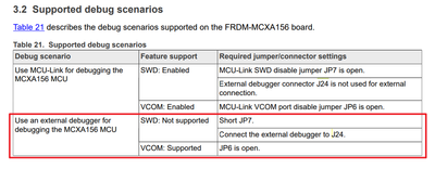

Please refer to table 21 of FRDM-MCXA156 Board User Manual . If you want to use external debugger, you must short JP7 and then connect the external debugger to J24.

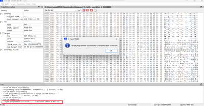

I have tested on my FRDM-MCXA156 board with J-Flash, it's okay to flash the firmware. Please check again on your side. Thanks!
Have a nice day.
