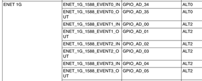

EdwinHz
Hi @davesi,
The reason why ENET_QOS does not have an EVENT0_IN anywhere in the RM is because it shares EVENT0_IN input with ENET_1G (as seen on the description of 1588_EVENT_IN of the following table):
This is how ENET_QOS can capture timestamping events. Do note that, although the port is the same, the pinmux is different:
BR,
Edwin.
