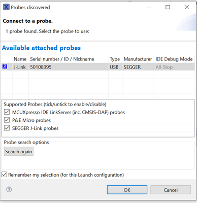

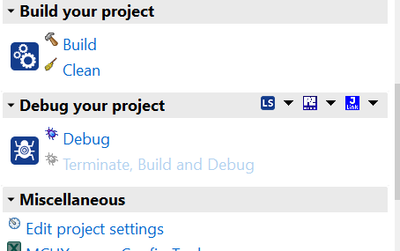

I am trying to flash my device using the MCUXpressoIDE. I am using this Debug icon in the QuickStart panel
#MKE14Zxxxxxx7

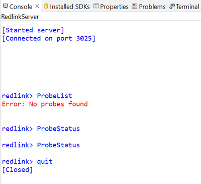

It is able to discover probe but in console it shows probe not found and when I select the probe in the screen, it quits and does not start the debug session. If anybody faced the similar problem and resolved it, please help me out here.

Hi @PoojaAgri
Based on this phenomenon, it indicates that your IDE has recognized the jlink, so make sure that the J-Link probe is properly connected to your device.
If possible, try using a different debug probe to see if the problem persists.
Hope this will help you.
