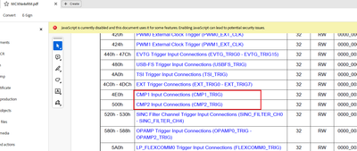

Hi NXP,
I am currently trying to use the comparator module in the MCX series.
However, I have noticed that the documentation does not provide detailed instructions on how to configure the SAMPLE/WINDOW signal.
Although the manual (MCXN 44.3.1, MCXA 41.3.1) note mentions "See the chip configuration section for the source of SAMPLE/WINDOW input." I have not been able to find the relevant description.
https://www.nxp.com/webapp/Download?colCode=MCXNX4XRM&location=null
https://www.nxp.com/webapp/Download?colCode=MCXAP64M96FS3RM&location=null
Could you please assist me in confirming how to proceed with the configuration?
If possible, I would greatly appreciate it if you could provide me with some examples.
Thank you very much!

Hi @onejoeluo
About "See the chip configuration section for the source of SAMPLE/WINDOW input."
Please check the MCX Nx4x Reference Manual 26  chapter Input Multiplexing (INPUTMUX).
Hope this will help you.
Hang
