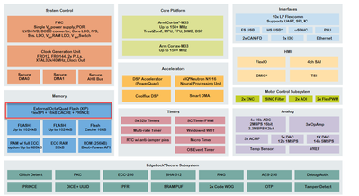

The MCX N94x series integrates a FlexSPI module, which enables running code from an external NOR flash memory.
Figure 2 MCX N94x block diagram

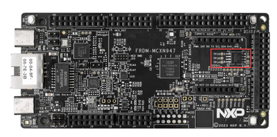

To follow this article, you will need the FRDM-MCXN947 Development board. Which is the evaluation board for the MCX N94x and N54x MCUs. The FRDM-MCXN947 integrates a W25Q64JVSSIQ QuadSPI flash memory. Therefore, this platform is perfect for creating an application that runs from an external flash memory.
Figure 3 External NOR flash memory on FRDM-MCXN947

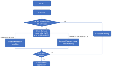

Also, the boot ROM takes responsibility for the boot flow. It selects whether to boot from on-chip flash memory, external flash memory, or ISP mode.  The figure below shows an extremely simplified boot flow, which gives an overall understanding of the chip boot flow.  For more details on the boot flow mechanism refer to the section Top-level boot flow of the MCX Nx4x Reference manual.
Figure 4 Simplified boot Flow
After the reset handling routine, the boot ROM will take control of the chip’s boot flow. It will begin with pertinent chip’s initialization. Then will check the status of the ISP pin. If the ISP pin is currently asserted, the ISP boot handling routine will be executed. ISP or  In-system programming is an execution mode where the boot ROM will wait for commands from an external host, over protocols like UART or USB, to do actions like read and write the chip memory, burn fuses, and many more. If the ISP pin is not asserted, the boot ROM will continue to determine the boot mode. Boot mode can be controlled with the CMPA[BOOT_SOURCE] bit of the CMPA of the PFR or eFUSES. If  CMPA[BOOT_SOURCE]= 01b the boot ROM will run FlexSPI NOR boot handling routine. If CMPA[BOOT_SOURCE] is 00b or 11b internal flash memory handling routine is executed. After the boot mode selection, the image will be validated. If it is not valid, for example, is not present in memory, is corrupted, or does not have proper format,  the ISP boot handling routine is executed. If the image is valid, finally the boot ROM will perform the jump to the user´s application.
The default boot flow is by internal flash, most of the SDK examples will be configured to boot from internal flash, as CMPA[BOOT_SOURCE] equals zero by default, or when CMPA area is erased. According to the Simplified bot Flow diagram, we need to make boot ROM go to FlexSPI NOR boot handling routine, to boot from the external flash. Therefore, we need to make   CMPA[BOOT_SOURCE] = 01b.

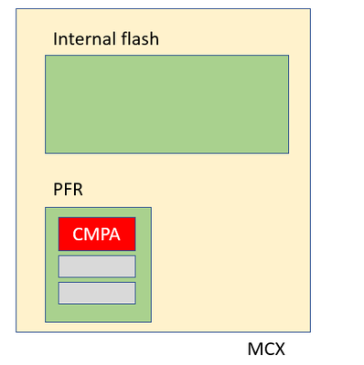

The PFR holds critical boot and security settings that are monitored by the boot ROM after every reset. As just described earlier, the CMPA area can be used to control boot mode. Therefore, PFR areas need to be carefully configured, as they control boot flow and also security features of the chip. The below figure shows a very minimalistic representation of the PFR containing the CMPA, next to the internal flash.
Figure 5 PFR's CMPA area
For specific details of the PFR  please refer to the MCXNx4x_IFR.xlsx, attached to the MCX Nx4x Reference Manual.

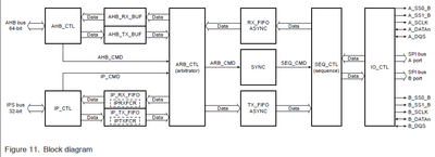

To do XIP the MCX  N94x requires a capable peripheral with the ability to fetch instructions from the external memory. The FlexSPI module is capable of doing this. The FlexSPI does support several types of external memories. One of them is Serial NOR Flash.
To interface the external memory with the FlexSPI supports SPI. SPI is an excellent serial protocol for short-distance and high-speed communications. The term QuadSPI could be simply understood as an implementation of the SPI protocol, where instead of having a single Data line, there are 4 data lines. SPI also supports two, and eight data lines.
Flexible Serial Peripheral Interface (FlexSPI) memory controller supports connection to external serial NOR, NAND, and RAMs.
It supports two SPI channels and up to four external devices. Each channel supports Single/Dual/Quad/Octal mode data transfer (1/2/4/8 bidirectional data lines).
Flexible sequence engine (LUT table) to support various vendor devices (serial NOR, serial NAND, HyperBus, FPGA, etc).
Memory-mapped read/write access by AHB Bus
  • AHB RX Buffer implemented to reduce read latency. Total AHB RX Buffer size: 1024 Kbytes
  • 8 flexible and configurable buffers in AHB RX Buffer
Software triggered Flash read/write access by IP Bus
  • IP RX FIFO implemented to buffer all read data from External device. FIFO size: 1024 Bytes
  • IP TX FIFO implemented to buffer all Write data to External device. FIFO size: 1024 Bytes
  • DMA support to fill IP TX FIFO
  • DMA support to read IP RX FIFO
Figure 7 FlexSPI block diagram

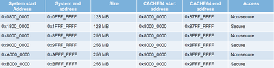

FlexSPI system memory map regions are remapped to different addresses at the FlexSPI sub-module:
Figure 8 FlexSPI memory map

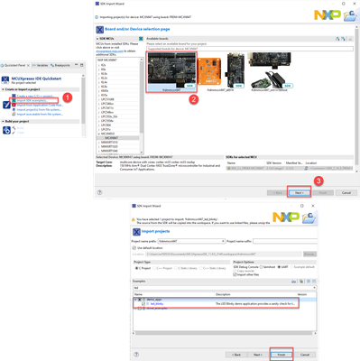

This section shows how to create an XIP bootable image from the  MCUXpresso SDK  led_blinky example.
  1.  Import the led_blinky demo from the SDK.  Click on “Import SDK example(s)…” (1), then search and select the FRDM-MCXN947 (2), and click “Next” (3). Inside the “SDK import wizard” search and select the “led_blinky  demo (4) and click on “Finish” (5)
Figure 11 Import the blinky example.

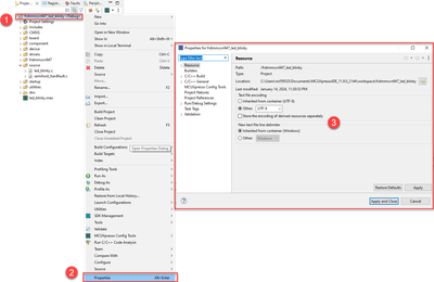

  1.  Once the demo project is imported open the project properties. Do a right-click in the project’s name (1), then click on “Properties” option (2) and open the project properties(3)
Figure 12 Project ´properties

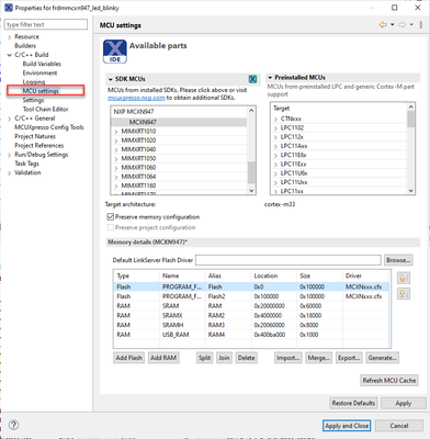

  1. Navigate to the Properties> C/C++ Build > MCU settings section
Figure 13 MCU settings window

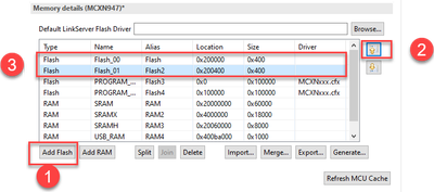

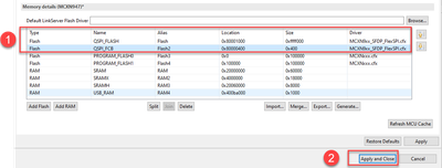

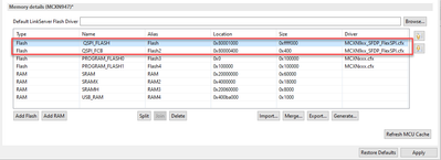

  1. Make sure that there are two  Flash areas for the external memory: QSPI_FLASH and             QSPI_FCB as shown in Figure 14. If the areas are missing add them as shown in the next step.
Figure 14 External flash areas in the linker.
  1. Add the two flash areas for the  QSPI_FLASH and QSPI_FCB in the “Memory details” table, the move them to the Top.  Click in “Add Flash”  (1) twice, then click on “Move selected memory up in table” (2), the two newly created flash areas should be placed at the top.
Note: Moving a memory area to the top of the “Memory details” table indicates the linker that text and data should be placed preferably in that area.
  1. Update the newly created flash areas name and parameters with the ones from the below table.
Type
Name
Alias
Location
Size
Driver
Flash
QSPI_FLASH
Flash
0x80001000
0xFFFF000
MCXN9xx_SFDP_FlexSPI.cfx
Flash
QSPI_FCB
Flash 2
0x80000400
0x400
  1.   Make sure that the flash areas match the ones shown in the Figure 15.
Figure 15 Configured flash areas

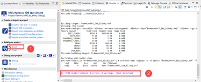

  1.  Click “Build” (1), once compilation is finished, should return 0 errors (2).
Figure 16 Successfully compiled image.
                                     Note: You should see that the QSPI_FLASH section is being used and that the PROGRAM_FLASH section is not.

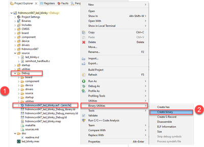

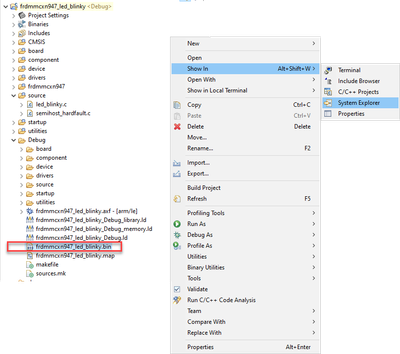

  1. Generate the binary. Navigate to the project’s debug folder and locate generated .axf (1). Then do a right-click in the .axf, and click on Binary utilities > Create Binary.
Figure 17 Create binary.
7 The binary should appear in the debug folder. Get  easily get the binary location by doing a right click on the binary and navigating to  “Show in>System Explorer”
Figure 18 Get created binary with ease.
  1. 8. Paste the binary into the workspace where you created the cmpa_bin.bin. This step is only to simplify the commands shown later on.

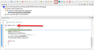

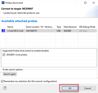

1  Attach the debugger to the running target and place a breakpoint at any part of the code.
Figure 21 Attach debugger to a running target.
  1. Once your debug probe is discovered, click “OK.”
  1. Halt the processor execution. Use the debug button.
Figure 22 halt execution.
  1. Reset processor. Use the “Restart button”. The program should be stop at the first line of the main function.
Figure 23 Breakpoint at main.

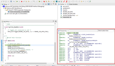

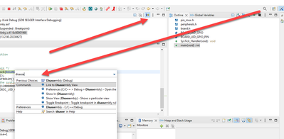

  1. Find and open the disassembly view. Click on “Instruction Stepping Mode” button or search for disassembly. Any option will open the MCUXpresso “Disassembly” view.
Figure 24 Open "Disassembly" view
  1. Processor must be running at 0x8000_0000 address space. On the disassembly view you can check that the instructions are executed from address on the range of 0x8000_xxxx which is assigned for external flash.
Figure 25 Running code from external flash.
