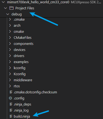

I was happily using VS Code building RT700 code using mcuxsdk repo 25.12.00.
All the sudden my projects would not build and I saw message:
Workspace is /c:/projects/mcuxsdk/mcuxsdk/examples/demo_apps/hello_world
build task started....
"C:\Program Files\CMake\bin\cmake.EXE" --build C:/projects/mcuxsdk/mcuxsdk/examples/demo_apps/hello_world/debug --target all --
ninja: error: loading 'build.ninja': The system cannot find the file specified.
I am sure I did something.

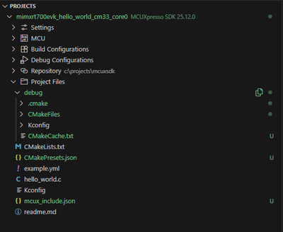

I removed the repo and re-cloned. Reimported core0 hello world.
Any ideas? Thank you.
Still same.

3 返答(返信)
6,938件の閲覧回数
fsl_jason_yu
Hi @dan_ash ,
I didn't see this issue before. Could you please confirm:
1. The new cloned repo is clean.
2. The imported project folder is clean.
3. When you see the error, does the file "ninja.build" exist?
6,934件の閲覧回数
dan_ash
@fsl_jason_yu ,
This is all I see.
No ninja.build, but it was there before when things works.
6,924件の閲覧回数
