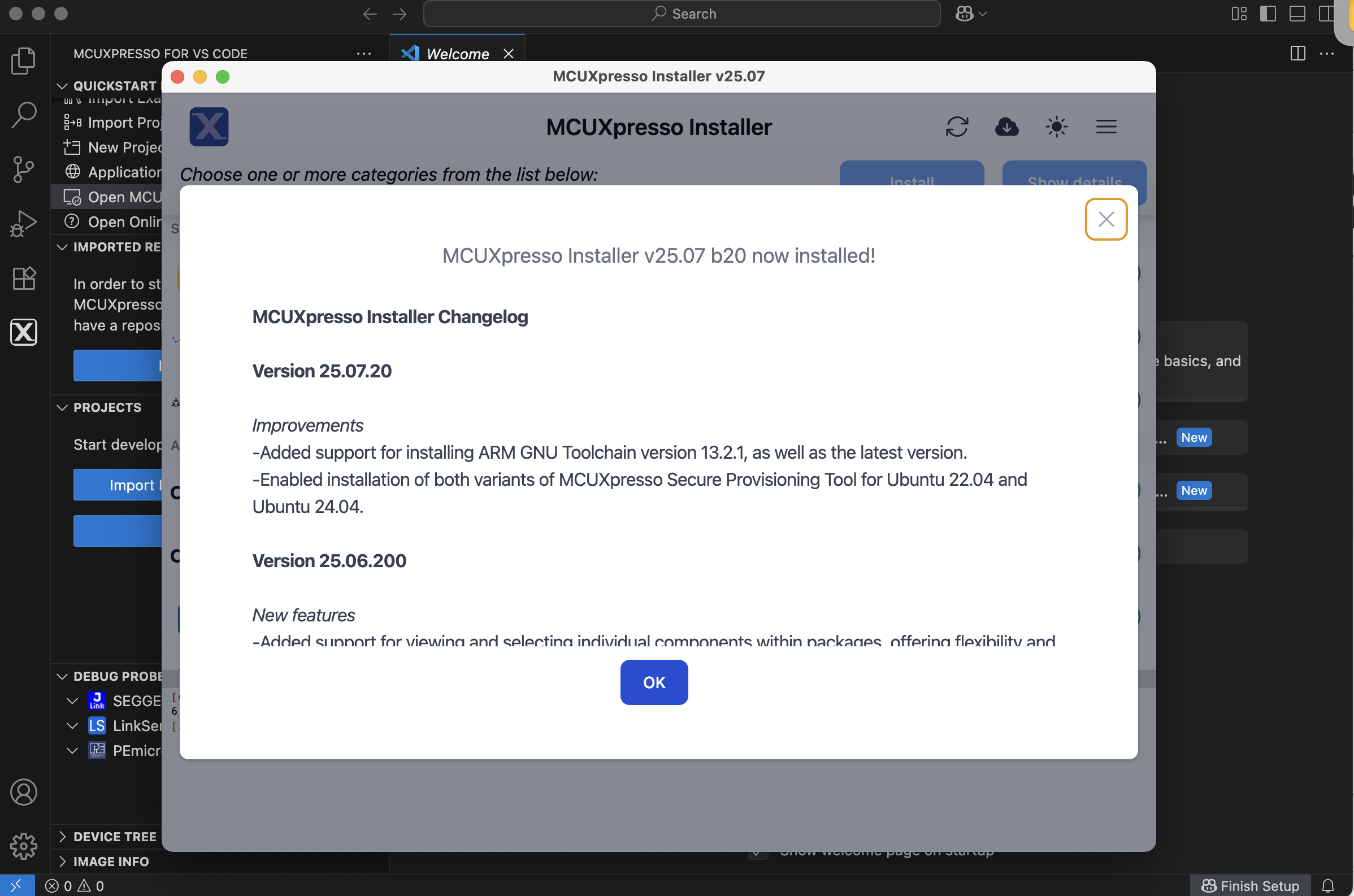

I am attempting to install MCUXpresso for VSCode, the MCUXpresso Installer, and the software kits for Zephyr Developer on a new MacBook Pro M4 Max. I have previously successfully installed on an older Intel MacBook Pro.
I can successfully install VS Code, the MCUXpressor extension, and the MCUXpresso Installer. When I try to install the Zephyr Developer kit, it will not completely install and it continually wants me to reboot VS Code to reload environment variables. As far as I can tell, errors are preventing it from continuing with the install.
I have reinstalled VSCode after deleting the .vscode hidden file. That restored VSCode to its original state and forced me to reinstall the MCUXpresso extension. That did not fix the problem. The problem apparently is caused by errors while loading certain zephyr components.
Here is the exact sequence of events and screen shots:
1. Delete VSCode, the hidden .vscode configuration file, and MCUXpresso Installer.
2. Reinstall VS code
3. Reinstall the MCUXpresso Extension. I note that the MCUXpresso icon does not appear in the VSCode toolbar until I restart VSCode. I'm not sure but I think it automatically appeared on the older MacBook.
4. Restart VSCode. MCUXpresso is installed and available in the tab bar.
5. Click on it and in the Quickstart Panel, select Open MCUXpresso Installer. The arm64 version of the installer is installed showing the Changelog. See screenshot.
6. When the Changelog goes away there are errors shown.
[error] Error running command /Users/clark/zephyr-sdk-0.17.0/arm-zephyr-eabi/bin/arm-zephyr-eabi-gcc: spawn Unknown system error -86
[info] Latest MCUXpresso Installer version is installed.
See screenshot.
7. Click on Zephyr Developer and Show Details. See screenshot.
8.Click Install. Immediately a window pops up that says MCUXpresso Installer has updated the environment variables and instructing me to restart VSCode. See screenshot.
9. In order to restart I note that I must close both VSCode and MCUXpresso Installer. If I do not close the installer, the app hangs while trying to determine what has been installed. It appears to permanently hang.
10. Close hung MCUXpresso Installer.
11. In the Quickstart panel, click Open MCUXpresso Installer. This brings me right back to the installer changelog screen as shown on step 5. This process appears to repeat indefinitely.

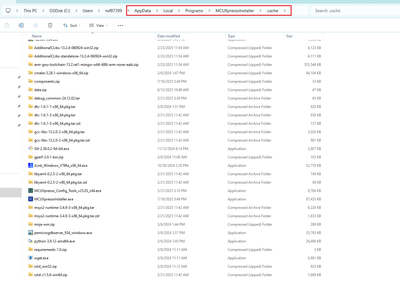

1.Is there any way to do that besides a format of the hard drive?
I think you can find the installed path.
For windows.
And delete the related files.
2.Regarding the MacBook with the M4 processor, with homebrew installed, will the extension install the ARM64 zephyr SDK?

The MCUXpresso Installer for macOS requires Homebrew to be installed as a prerequisite. It is mentioned in the attached log files that Homebrew is not present on the system. In this case, it is related to is being a new macOS installation, which does not include Homebrew out-of-the-box. Unfortunately, it cannot be automatically installed, so this action will have to be performed manually by the user before attempting any future operation using the MCUXpresso Installer.
The hang encountered on the Loading packages page is an effect of closing the MCUXpresso Installer application using the window's "X" button, instead of going through right clicking the dock icon -> Quit. (This behavior will be fixed in the next release)

Now that homebrew is installed, I’d like to repeat the complete zephyr install using vs code and the NXP extension. But first I’d like to remove the zephyr files that have already been installed so the extension fully reinstalls zephyr. Is there any way to do that besides a format of the hard drive?
For windows.
