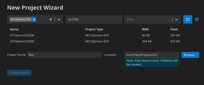

However, when creating a new project against the MCUXpresso SDK version 24.x, MCUXpresso will only allow me to select EVK/EVM boards.  The closest option that MCUXpresso allows me to choose is the LPC55S06--and no, I can't type in LPC5506: the "Create Project" button is disabled unless I click on an existing EVK option...which is only the LPC55S06 or 55S69:
I don't think this is close enough to allow me to program an LPC5506, as it is quite different from the LPC55S06.

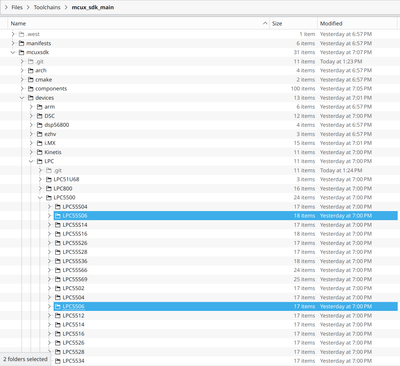

But this doesn't make sense, as folders for the LPC5506 (and all the other variants) are scattered all throughout the entire SDK 24.x version I already downloaded:

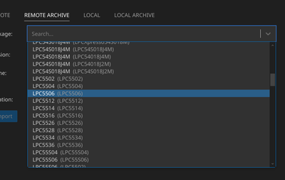

Digging around, I found that I could download a "Remote Archive" specifically for the LPC5506:
And then I could "Import Example from Repository", and select the LPC5506-specific repository I'd downloaded.

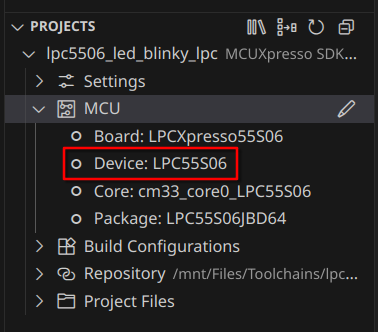

But once again, I was forced to select the LPC55S06 development board:
And the resulting project configuration clearly shows the CPU specification as LPC55S06, not the LPC5506 I had specifically targeted with the repository:
