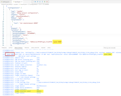

Dear Support,
I was wondering if there is a possibility to configure the programming/flash speed of the JLink debugger. Currently, it is fixed to 4000 but I can't seem to find any settings to change this.
A higher speed could greatly increase our productivity as programming the device is starting to get longer and longer the more our project grows.
Kind regards,
Maxim

Hi @Maximvda ,
this is how I did it:
I hope this helps,
Erich

We are not using the rtos plugin but by pointing it to a useless directory I got it working.
Example: "mcuxSeggerRTOSPlugin": ".vscode -speed 8000",

Hello, I have reviewed your information and maybe the J-Link commander tool helps you, this has the possibility to change the speed.
Pavel
