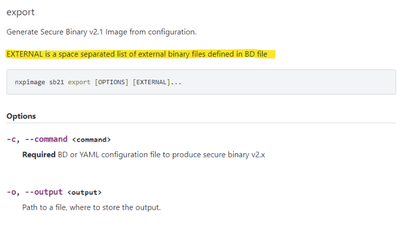

in my project I use elftosb tool with kinetis option, like this:
elftosb -f kinetis -V -c .\path_to_bd_file.bd -o .\out_image.sb .\my_bin_file.bin
but, since elftosb is deprecated by nxpimage, I tried to use it the same way before
nxpimage sb21 export -c .\path_to_bd_file.bd -o .\out_image.sb .\my_bin_file.bin
but i get error:
GENERAL ERROR: KeyError: 'options'
I already asked for help here: https://community.nxp.com/t5/i-MX-RT/Specific-bytes-at-the-beginning-of-binary-file-don-t-allow-to/m..., but no one was able to help, that's why I created another question, that's more focused on how nxpimage should be used to replace elftosb.

nxf46245
Hello Maria,
what you are trying to achieve is building a Secure Binary 1.0 file which is unsigned and unencrypted file that contains
commands for flashloader to program the target device (It is not secure as the name say) The commands are equivalent to the commands in blhost, so you might try executing the commands in blhost directly.
It usually contains configuration of the external memory (Configure and fill command) and load of HAB to the memory.
Building of SB 1.0 file is not supported directly by NXPIMAGE tool. However, if that is really your usecase you can use SPSDK API to build the SB 1.0 (spsdk/sbfile/sb1/images.py).
If you want to create image that is able to boot from external flash memory, you can use the nxpimage bootable-image application.
This tool generates bootable image that contains FCB block, BEE encryption headers (optional) and HAB container. That is all what you need to boot from external flash memory.
