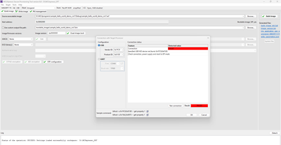

Hi Team,
I am using the MCUxpresso secure provisioning tool with IMXRT1170 eval board connected through the USB cable to the laptop.
But I am getting the below mentioned error when I run "Test connection". please help me resolve the issue as i am not able to write the image to the board using the tool.

Hi Jeevan,
SW1: ISP 0001, boot 0010;
for supply from USB: J38 3-4
for supply from UART: J38 7-8
For Octal Flash SW2-3 to 1
For OTFAD/IEE Encryption SW2-2 to 1
For SD CARD SW2-7 to 1
For SD CARD SW2-8 to 1
