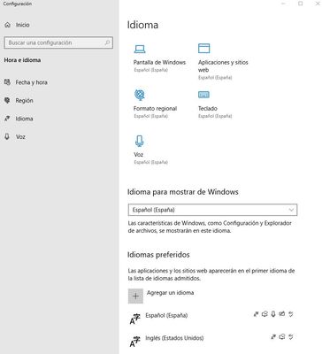

PedroBecerra
On windows 10 it doesn't works too. It closes suddently.

PedroBecerra
