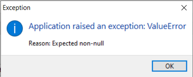

Hi I'm trying to use V8 of the Secure Provisioning Tool to connect to our MIMXRT1160-EVK and when I select the Debug Probe under the menu Target/Debug Probe it throws an exception straight away without showing the sub menu.   Application raised an exception ValueError.png
Is there a fix for this?

Hi Ian,
Debug Probe menu command is currently not supported for RT116x/7x. The command is supported for processors that contains debug probe selection on toolbar, like for example RW612 (see picture)
Thank you for reporting the problem, it will be fixed in next release. For now, we recommend to use the button on the toolbar instead of the command. We're sorry for inconvenience.
