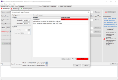

Hi, is there a guide for how to connect the IMXRT1160 EVK with the secure provisioning tool (V8) as I'm getting connection failed when trying to use the USB port. I've tried both USB1 & USB2 on the EVK but get the same result. Also does a specific example program need to be run when trying to connect?
Any suggestions greatly appreciated.
Kind regards
Ian

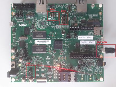

Hi Ian,
1. check the power supply,  J38 should be set to 3-4 for power from USB
2. check the switches to set the board to ISP mode: SW1: 0001  (to run the application, change the switch to 0010)
Here is the photo of RT1170-EVK, where the jumpers are located and where the cable should be connected. RT1160-EVK should be similar.
Marek

That's great thanks for the help, it was SW1 I needed to change to 0010
