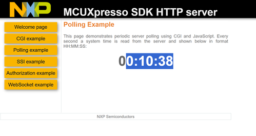

     We are testing the official SDK on i.mxrt1062 evk, but encounter a problem shown below.
     Can you help to check and fix it ?
      Thanks very much.
      EVK: MIMXRT1060-EVKB
      SDK: SDK_2_14_0_MIMXRT1060-EVKB
      Example: lwip_examples\lwip_httpsrv\freertos
      Test: EVK connects to switch (brand: VGREEN), mcu will crash after running 5-10 minutes; EVK connects to PC, mcu will run well.

I am currently doing sanity test on my end with latest SDK. For now, I am limited to use my PC and the RT1060-EVK. I am using demo's timer and checking if the page re-loads.
Could you help me with more details regarding the failure? I guess that you are not longer seeing the timer updating or the web page responding.
Currently I do not  know  about your VGREEN network switch setup . Also, Is this the switch between your PC and the EVKB? Is there any other device on the network?
I can not replicate with the same environment you have ( I do not have a switch), but I suggest the following:
- Use an sniffer an check if the  status of the session  between the EVK and the PC. For example, if there is time-out or if the session gets closed.
- After the demo stops working on your PC, do a ping to the demo. Check if there is any reply.
