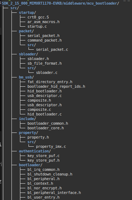

I am interested in what I find in middleware/mcu_bootloader (for example of SDK 2.15.000)
I cannot find these files (e.g. bl_main.c) in any repository
Can you tell me in which repository you have stored the middleware related to mcu_bootloader?

Sorry, the relevant code for mcu_boot is in our internal repository. Unfortunately, our mcu boot code has not been pushed to Github, so you can only refer to the code in SDK.

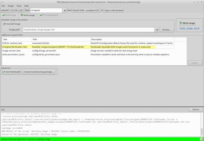

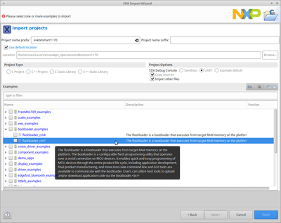

Can you confirm that the source files I find in the SDKs in the middleware/mcu_bootloader/ directory, and which are used for examples such as evkbmimxrt1170_flashloader_cm7:
are the ones used to get the flashloader executable that is used by Secure Provisioning Tool
best regards
Max
3,571件の閲覧回数
Harry_Zhang
Hi @mastupristi
Yes, they are the same.
Hope this will help you.
Hang
