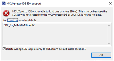

hello friends,
i generated the SDK for host os linux and for windows and it could not be installed in mcuxpresso neither in windows or linux.
it tells me, that its not generated for the mcuxpresso version.
any ideas?
Best
Ralf

By the way, on a Linux host with MCUxpresso installed, no SDK can be installed as an archive with Linux selected as host, .tar.gz files will be generated and MCUxpresso only offers a fixed .zip filter when importing an SDK archive under Linux. Therefore, only Windows can be selected as the host during generation (highlighted in yellow). Even if it has been selected (marked red) that the SDK should support both toolchains (IAR and gcc), it is reported that no supported toolchain is available. Do I have to install them myself? Which would be the correct one for the Cortex-M7 under Ubuntu in this case?

no i generated an older SDK Version: SDK_2_14_0_MIMX8ML8xxxKZ
if i try to import archive inside sdk window, i still get the error. The error message tells me:
eclipse.buildId=unknown
java.version=17.0.7
java.vendor=Eclipse Adoptium
BootLoader constants: OS=linux, ARCH=x86_64, WS=gtk, NL=de_DE
Command-line arguments: -os linux -ws gtk -arch x86_64
com.nxp.mcuxpresso.datamodels.generic
Error
Thu Apr 25 13:42:19 CEST 2024
The SDK 'SDK_2.x_MIMX8ML8xxxKZ' does not contain any MCUXpresso IDE compatible toolchain.
at com.nxp.mcuxpresso.core.datamodels.providers.SDKManifestProvider.addToMap(SDKManifestProvider.java:984)
at com.nxp.mcuxpresso.core.datamodels.providers.SDKManifestProvider$2.visitFile(SDKManifestProvider.java:715)
at com.nxp.mcuxpresso.core.datamodels.providers.SDKManifestProvider$2.visitFile(SDKManifestProvider.java:1)
at java.base/java.nio.file.Files.walkFileTree(Files.java:2811)
at java.base/java.nio.file.Files.walkFileTree(Files.java:2882)
at com.nxp.mcuxpresso.core.datamodels.providers.SDKManifestProvider.refresh(SDKManifestProvider.java:681)
at com.nxp.mcuxpresso.core.datamodels.SDKChipVendorDatabase.refresh(SDKChipVendorDatabase.java:855)
at com.nxp.mcuxpresso.core.datamodels.ui.views.SDKView.doDBRefresh(SDKView.java:2041)
at com.nxp.mcuxpresso.core.datamodels.ui.jobs.SDKImportJob.run(SDKImportJob.java:124)
at org.eclipse.core.internal.jobs.Worker.run(Worker.java:63)
 the sdk builder says (highlighted in yellow):

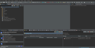

Ralf_Rademacher
Thanks Harvey021
but now, as you can see
the SDK is inside Project Explorer and not under installed sdks?! is this correct?
Ralf
1,837件の閲覧回数
Harvey021
Try to import it as File -> Import Projects from File System or Archive -> Directory
