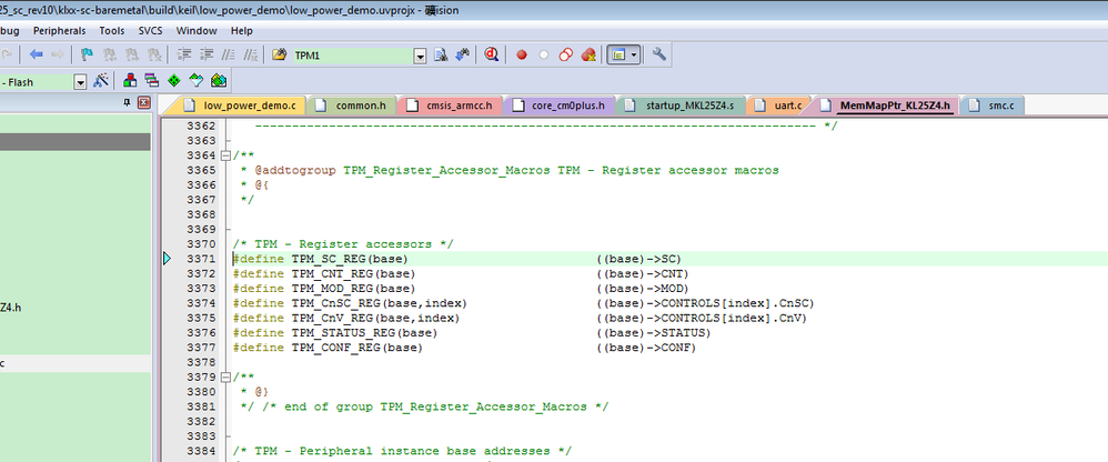

    TPM1_BASE is just the address, you can find this define:
It is still the pointer, so you need to use -> instead of _.
If you want to use the _, eg, TPM1_SC, you must have the definition like the bare metal code for KL25:
You can find, actually, the root still use ->, you can use the _ directly, because in your old CW project, it has the definition file like memMapPrt_kl25z4.h.
Actually, just modify the "_" to "->" is not complicate, you can try it on your side.
Wish it helps  you!

kerryzhou
Hi PT CAOS,
   It is determined by your project head file, if your header file already define the register" _", then you can use it.
  But some header file just define the register point, then you need to use"->".
  From my own opinion, you can refer to the official SDK code, then it will help you to understand it.
Kerry
