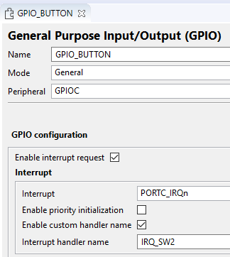

I'm trying to start a new project and add some peripherals, one of them is the gpio interrupt, but i can't get it to work properly. If i import the example it works fine, but when add as a peripheral it doesn't work.
I'm working with a FRDM-K64F and want to make an interrupt with the SW3 switch of the board wich is in the PIN 6 of PORTC.
This is the generated code in
peripherals.h:
/* Alias for GPIOC peripheral */
#define GPIO_BUTTON_GPIO GPIOC
/* Alias for PORTC */
#define GPIO_BUTTON_PORT PORTC
/* GPIO_BUTTON interrupt vector ID (number). */
#define GPIO_BUTTON_IRQN PORTC_IRQn
/* GPIO_BUTTON interrupt handler identifier. */
#define IRQ_SW2 PORTC_IRQHandler
peripherals.c:

Then implement my IRQ handler in main.c:
void IRQ_SW2(void){
    /* Clear external interrupt flag. */
     GPIO_PortClearInterruptFlags(GPIOC, 1U << 6);
     /* Change state of button. */
     sw2_interrupt = true;

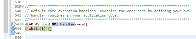

But it never enter in this function handler.
When push the button, it always goes directly to:
And stays there forever.

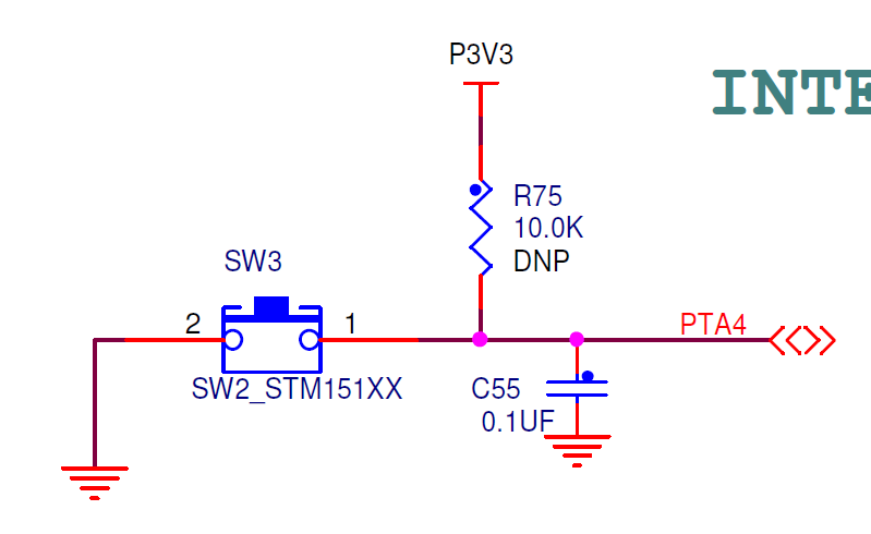

Hi Alejandro:
SW3 in Frdm-k64 board is very special, it connects to NMI.
I would suggest you try SW2.

alejandrovelez
Hi danielchen@fsl‌, Thanks for your answer, seems i've been pressing the wrong switch :smileyconfused:.
