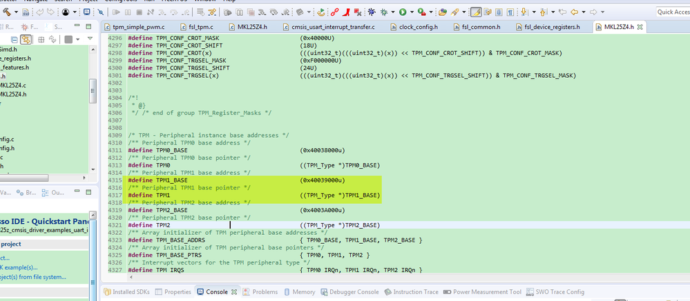

No no, if file $HOME/workspace/Test/CMSIS MCUX has added CMSIS subfolder that contains a copy of "MKL25Z4.h" file (includes file). In that file, there are some defined variables that start with "#define TPM1_" and continue with other names as "TPM1_BASE". So I don't understand why solution to my problem could be what you say (changing "-" to "->").-
Why?
Thanks!
2,715件の閲覧回数
kerryzhou
Hi PT CAOS,

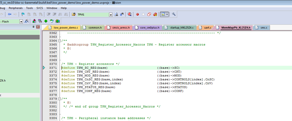

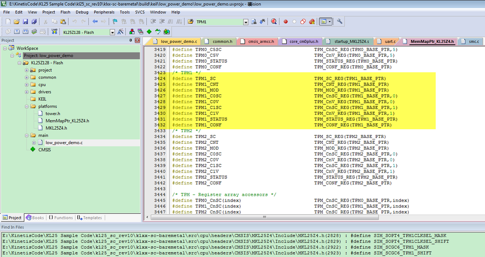

    TPM1_BASE is just the address, you can find this define:
It is still the pointer, so you need to use -> instead of _.
If you want to use the _, eg, TPM1_SC, you must have the definition like the bare metal code for KL25:
You can find, actually, the root still use ->, you can use the _ directly, because in your old CW project, it has the definition file like memMapPrt_kl25z4.h.
Actually, just modify the "_" to "->" is not complicate, you can try it on your side.
Wish it helps  you!
Kerry
