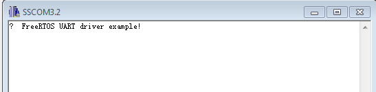

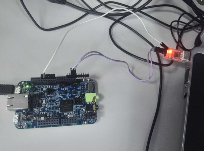

Hi Jeremy Anderson:
I did a quick test according to your modifications. I tested with my uart-to-usb , and it can work on my side.
My modifications :
1. pin_mux.c
void BOARD_InitPins(void) {
  CLOCK_EnableClock(kCLOCK_PortC);                           /* Port B Clock Gate Control: Clock enabled */
  PORT_SetPinMux(PORTC, PIN3_IDX, kPORT_MuxAlt3);           /* PORTB16 (pin E10) is configured as UART0_RX */
  PORT_SetPinMux(PORTC, PIN4_IDX, kPORT_MuxAlt3);           /* PORTB17 (pin E9) is configured as UART0_TX */
 2 freertos_uart.c
#define DEMO_UART UART1
#define DEMO_UART_CLKSRC SYS_CLK
#define DEMO_UART_CLK_FREQ CLOCK_GetFreq(SYS_CLK)
#define DEMO_UART_RX_TX_IRQn UART1_RX_TX_IRQn
4,287 Views
