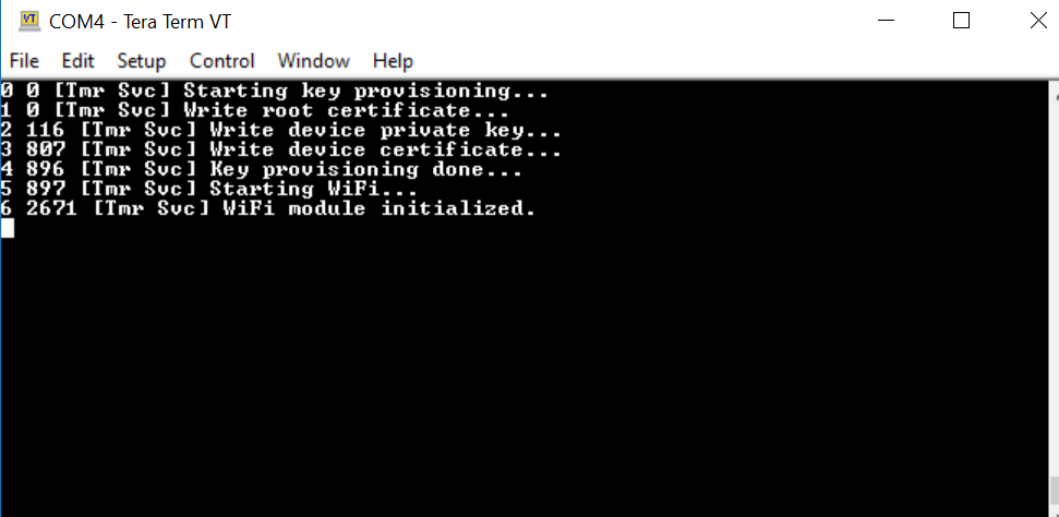

I'm working on NXP LPC 54018 IoT Module. I downloaded MCUXpresso IDE Version 10.2.1_795 and the latest MCUXpresso SDK 2.4.2 by adding the required software components. I'm using the SEGGER J-Link probe. I tried running the led_wifi_qspi_xip example from the aws_examples and attached image is what I see when I run the code as shown below. I just see the six lines of code in the Serial Terminal (Tera Term). I have a good WiFi connection with Internet access. I don't really have an idea of what's preventing this from connecting to the access point. Any help would be greatly appreciated.
Thank you,
Saranya

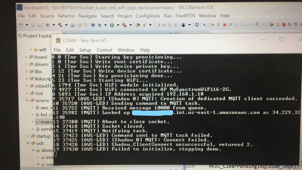

saranyachitta
I've already tried the steps that are shown in the link you sent. I used SDK 2.3.1 as suggested. It works fine for the aws_shadow_wifi_qspi_xip example. When I try the same procedure and work on the led_wifi_qspi_xip example, the output in the terminal is as shown below:
Please let me know what else could be done in order to avoid the issues and get the desired output.
Saranya
