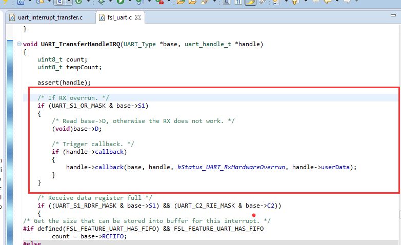

I think there's a logical bug in fsl_uart.c
/* If RX overrun. */
if (UART_S1_OR_MASK & base->S1) {
/* Read base->D to clear overrun flag, otherwise the RX does not work. */
 while (base->S1 & UART_S1_RDRF_MASK) {
      (void) base->D;
The "while (base->S1 & UART_S1_RDRF_MASK)" creates a problem when the routine gets preempted by another interrupt. The RDRF can be set again, causing the routine to eat up extra bytes and/or generate additional Rx OR interrupts. After removing the while loop and reading "(void) base->D;" exactly once, the problems go away.

Hello Paul,
Which chip do you used?
I randomly check one SDK package (FRDM-K22),
it just read D once :
Alice

Hi Alice_Yang‌,
It's the same in the latest SDK for TWR-K65F180M (2.4.1 2018-09-14).

NicolasP
Same problem with SDK 2.4.1 and K22FN51212
Nicolas

paulsandys
FRDM-KL25Z

Hello ,
Thanks for your sharing , I will report it to the SDK team.
And I recommend you can use the UART driver file of FRDM-KL26.
I also attached it for you.
Hope it helps
Alice
