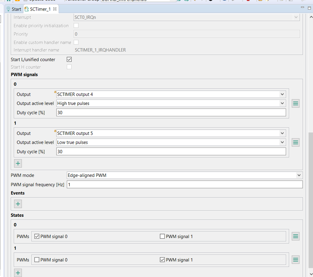

Is possible to configure the SCTimer as complimentary pair?
e.g.
SCT0_OUT4  with 100KHz period (+ variable Duty %)
SCT0_OUT6  complimentary output of (SCT0_OUT4)
regards,
Hemanth
3,099 次查看
Hello Hemanth,
Yes, just config output3 and output4 with opposite level.
Recommend you use the MCUXpresso Config to config it:

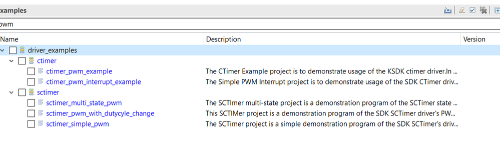

There are PWM demo under SDK:
Alice

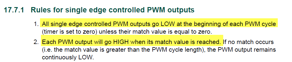

3,099 次查看
Hi Hemanth,
No, because  "All single edge controlled PWM outputs go LOW at the beginning of each PWM cycle.
Each PWM output will go HIGH when its match value is reached."
Alice
