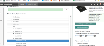

In SDK builder, the part support for MIMXRT1061xxxxB variants is incomplete. Is there somewhere else to look?

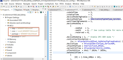

Hi @astrobuf ,
    You totally can use the A part code, take an example, as you know, the NXP MIMXRT1060-EVK board is the MIMXRT1062DVL6B, but if you check the related SDK project, you will find it also the A part.
Until now, I didn't find any issues.
About the A and B part difference, just check the errata document.
Wish it helps you!

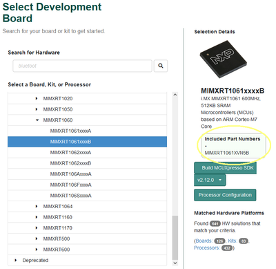

kerryzhou
Hi @astrobuf ,
   You are right, that is not the complete partnumber.
   Which detail MIMXRT1062xxxB part you want to use?
  The following part?
MIMXRT1061DVL6B
 MIMXRT1061DVJ6B
  If yes, I think you also can generate the A part,:
That software also can be used in the B part.
