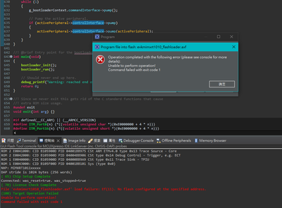

Hello NXP,
  I was flash NXP evkmimxrt1010_flashloader sample code to RT1010 EVK ,
but the result was fail. following was my flash log. Could you give me any advice or help?

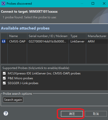

Executing flash operation 'Program' (Program file into flash: evkmimxrt1010_flashloader.axf) - Fri Aug 30 16:11:21 CST 2024
Checking MCU info...
Scanning for targets...
Executing flash action...

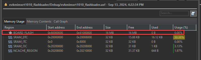

File 'evkmimxrt1010_flashloader.axf' load failure: Ef(11). No flash configured at the specified address.
(100) Target Operation Failed
Unable to perform operation!
Command failed with exit code 1

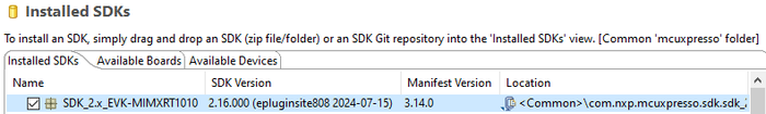

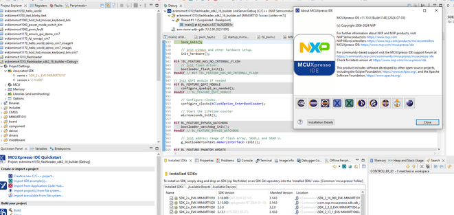

I have tried to replicate the issue with no luck. I used  MCUXpresso IDE v11.10 and SDK 2.16,  downloaded from the IDE, also called plug in SDK. In my case the flashlodaer can be loaded to RAM and debugged as expected.
Currently, I do not know why you received this error, but I want to troubleshoot this with you.
Could you try to import and debug  the flashloader on an different workspace ?
Did you obtained the SDK from https://mcuxpresso.nxp.com/en or from the IDE? which specific SDK version are you using?

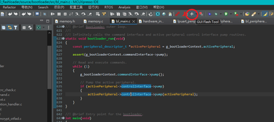

 As a side note

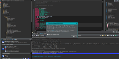

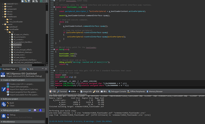

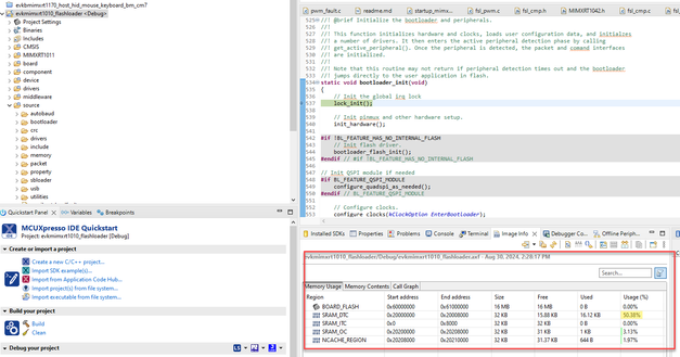

Following is my building and flashing method .
Do you use the same method as me?
In addition, after you load the flashloader sample code to RT1010,
can you see the debug messge form RT1010?
Build
Flash
3,488件の閲覧回数

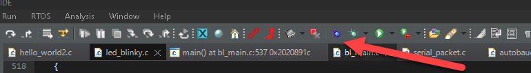

I see where the problem lies now, I did not understand before what you where doing different to me. You need to use the blue bug button
With this, the flashloader will be loaded to internal SRAM by the MCUXpresso IDE. In the SDK allmost all of the examples come linked to flash memory, but with the flashloader, this is a special case, we deliver this demo linked to internal SRAM.
Also the flashloader, does not integrates any boot headers. When booting an flash image  on the i.MX RT, the bootROM does need some  boot headers :   FCB ( flash configuration Block) and IVT ( image vector table). Those headers tell the ROM, on a high level description, how to initialize the flash and where is the start address of your application, tipically Reset ISR.
The flashloader it is not really a bootable image, as we deliver it on the SDK,  so you wont be able to execute it as it is. When clicking the blue bug button, the IDE does some "magic", the IDE basically, makes the MCU to start executing from resetISR. This is useful for development but not for production of a final application. On a normal boot flow, without the IDE, the ROM bootloader, or any bootloader, will be on charge of doing this.
The GUI flash tool, that you where using it is limited to write in the flash memory, and  the flashloader project comes linked to SRAM, so this will be an issue for you. For development and customization of the flashloader, it is okay to keep it linked to RAM. Consider that after a reset, the flashloader will be lost, as this memory is volatile.
The flashloader that we deliver, is designed to be temporally on SRAM, and aid to write images to non-volatile memories, like flash.

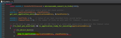

    Also you talk about flashloader does not integrates any boot headers, but in flashloader examples project , I trace some code seem for jump to start address of ours application.
    If flashloader doesn't include booting an flash image function ,could you please provide the corresponding sample project on MCUxpresso?(My target is execute the application by using the bootloader )

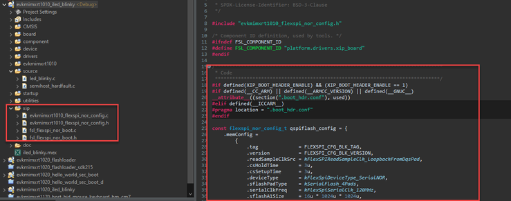

About the boot headers, I meant to the contents of the XIP folder that you can see on most of the SDK examples. The XIP  folder files define structures that tell bootloader about the application's configuration to be executed from flash.  Belo an example picture.
The  RT1010 flashloader does not contain those boot structures. In other words, the flashloader project does not contain those structures to be booted by the ROM, as a normal XIP flash application. Current demo requires to be loaded in SRAM by the SDPHOST, or by the IDE as we tried already.
You can still try link the flashloader to flash, add XIP folder. The flashloader project does integrates a custom linked script, and you need to manually link some portions to SRAM and others to flash, but currently I do not have guidelines to do this.

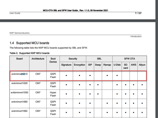

If you are looking for a solution that writes and jumps to your application FW without code modifications. I would recommend taking a look at the our SBL.
The SBL does supports RT1010 and source code is available. The current downside is that it is not available for the MCUXpreso's compiling toolchain ( you will need to install ARM GCC toolchain). However, this should not be a limitation as the  MCU-OTA SBL and SFW User Guide provides setup instructions.
The SBL will allow you to do most of the basic things that the flashloader does: receive an image and write the image into flash. The advantage is that the SBL is a flash resident bootloader, and will be stored and execute from flash.

Omar_hong
Hi @diego_charles ,

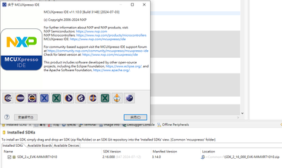

  Here is my IDE and SDK version, and I have try this on different workspace, but it still can't work.(I got this SDK from https://mcuxpresso.nxp.com/en/dashboard)
I've tried other sample project(Hello_world  & iled_blinky) and they seem to work fine

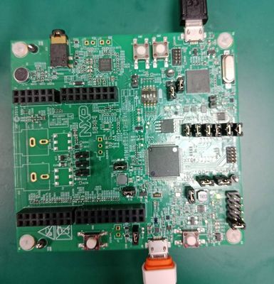

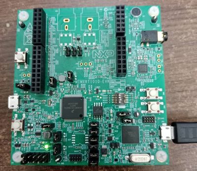

The following is the configuration status of my EVK board
3,699件の閲覧回数
diego_charles
Hi @Omar_hong
Thank you for your reply and cooperation!
 I see your configuration of the EVK as correct. I tested again with the same SDK you just  get and I can load the flashloader using the IDE. It seems that we are missing a little detail to avoid this error, but I still do not know what it is.

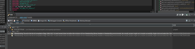

In the process of build, it can't get the .axf file,I was modify the project name to fix this issue.
In addition, I was use Quick Fix to fix following issue.
Fix above issue, this packege still can't run on my workspace.

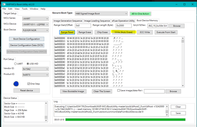

I was use .axf file in this package to create bin file, and use NXP-MCUBootUtility write to flash. It seem to write success(use "Range Read" to verify ) .
After reset device and read out the data , it was not written successfully
In this state, even if SW8 is set to 0010, the ev-board can be captured by MCUBootUtility.
