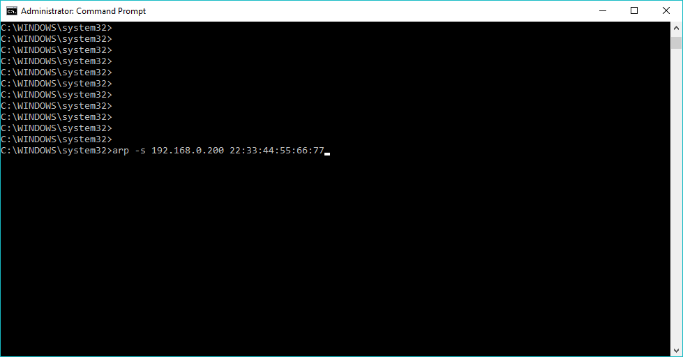

I am using s32 design studio for NXP #mpc5748g enet dev kit. Here LWIP example code "lwip_mpc5748g" integrated with freertos by default.But ,when  ping the ip address of MPC5748G dev kit,it dose not reply.I want to know how to use this example.How to config the board as client or server?

root cause of this issue is that LwIP example cannot handle ARP protocol, so you must add MAC address of the board manually into PC ARP cache.
Run command line as an administrator and use the command shown in the figure below.
Addresses used in the figure are the default ones in the lwip project.
Martin
