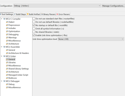

I'm using relatively new version of MCUXpresso IDE (v11.8.1 [Build 1197] [2023-10-27]) and no matter what type of example project I import, it fails upon compilation when I turn on LTO (Link Time Optimization) - both for the compiler and linker. The result is the same, no matter what type of optimization level for LTO is chosen. it also does not matter if it's Debug or Release build.
Example used: evkmimxrt1170_shell_cm7 - however, any other example I tested leads to the same result.
The additional options I set after importing project from SDK Wizard:
mimlo_0-1708624016078.png (LTO enabled, level None, every combination of other 2 options were also tested when on/off)

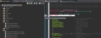

../device/system_MIMXRT1176_cm7.c:73:21: warning: type of 'g_pfnVectors' does not match original declaration [-Wlto-type-mismatch]
   73 |     extern uint32_t g_pfnVectors[];  // Vector table defined in startup code
../startup/startup_mimxrt1176_cm7.c:552:15: note: 'g_pfnVectors' was previously declared here
  552 | void (* const g_pfnVectors[])(void) = {

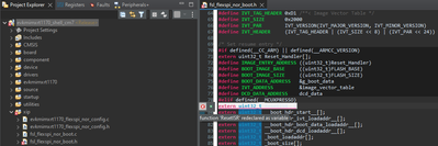

../xip/fsl_flexspi_nor_boot.h:79:17: error: function 'ResetISR' redeclared as variable
   79 | extern uint32_t ResetISR[];
../startup/startup_mimxrt1176_cm7.c:843:6: note: previously declared here
  843 | void ResetISR(void) {

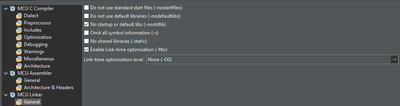

Hi @mimlo ,
Hope you are doing well!
Try configuring the IDE like this in the picture below:
And this thread may help you on this topic. Hope this helps!

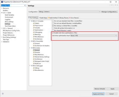

mimlo
Hi @Gavin_Jia ,
I did the following steps.
1.) Removed the shell project.
2.) Imported new one with default settings
3.) Set the MCU Linker flag as on your screen
4.) Set proper lib for build

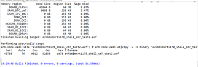

5.) Compiled the project
It worked correctly. The possible reason behind my previous failure was this information prompt that show up when a user hovers mouse pointer over the lto linker option:
It does not work only if I do exactly as the message prompt suggests me to do.
If I understand it correctly, it does not take effect if it is enabled only in there. It must be enabled on the end as well, so even though that option allows for the project to compile, it does not take any effect I'm afraid
I think it could be corrected in some of the future MCU IDE releases if someone else if able to reproduce the issue.
