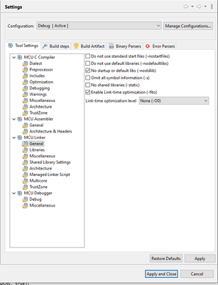

The build log:
Building target: application.axf
Invoking: MCU Linker
arm-none-eabi-gcc -nostdlib -L"H:\gerrit\WLC_LPC804\v11\Maxeye\source" -Xlinker -Map="application.map" -Xlinker --gc-sections -Xlinker -print-memory-usage -mcpu=cortex-m0 -mthumb -T "App_USI141_Debug.ld" -o "application.axf" ./src/WlcDeviceApp.o ./src/WlcDeviceApp_Mcu.o  ./WlcDeviceLibrary/wlc_device/wlc_appproc.o ./WlcDeviceLibrary/wlc_device/wlc_chgproc.o ./WlcDeviceLibrary/wlc_device/wlc_crn120.o ./WlcDeviceLibrary/wlc_device/wlc_crn120cfg.o ./WlcDeviceLibrary/wlc_device/wlc_device.o ./WlcDeviceLibrary/wlc_device/wlc_ndef.o ./WlcDeviceLibrary/wlc_device/wlc_optional.o ./WlcDeviceLibrary/wlc_device/wlc_utility.o ./WlcDeviceLibrary/wlc_charge_rx/PCA943x/pca9430-charger.o ./WlcDeviceLibrary/wlc_charge_rx/PCA943x/pca9431-vout.o ./WlcDeviceLibrary/wlc_charge_rx/PCA943x/pca943x-adc.o ./WlcDeviceLibrary/wlc_charge_rx/PCA943x/pca943x-otp.o ./WlcDeviceLibrary/wlc_charge_rx/PCA943x/pca943x-rect.o ./WlcDeviceLibrary/wlc_charge_rx/PCA943x/pca943x-rxir.o ./WlcDeviceLibrary/wlc_charge_rx/PCA943x/pca943x-vpwr.o ./WlcDeviceLibrary/wlc_charge_rx/PCA943x/pca943x.o ./WlcDeviceLibrary/wlc_charge_rx/wlc_chg_rx_adc_pca.o ./WlcDeviceLibrary/wlc_charge_rx/wlc_chg_rx_charger_pca.o ./WlcDeviceLibrary/wlc_charge_rx/wlc_chg_rx_pca.o ./WlcDeviceLibrary/wlc_charge_rx/wlc_chg_rx_rxir_pca.o ./WlcDeviceLibrary/wlc_charge_rx/wlc_chg_rx_vout_pca.o ./WlcDeviceLibrary/wlc_charge_rx/wlc_chg_rx_vpwr_pca.o ./WlcDeviceLibrary/wlc_charge_rx/wlc_chg_rx_vrect_pca.o ./WlcDeviceLibrary/wlc_charge_rx/wlc_chg_rx_vtune_pca.o ./WlcDeviceLibrary/CRN120_1.0.0/HAL_CRN120/CRN120_driver.o ./SDK_2.7.0_LPC804/devices/LPC804/mcuxpresso/startup_lpc804.o ./SDK_2.7.0_LPC804/devices/LPC804/drivers/fsl_acomp.o ./SDK_2.7.0_LPC804/devices/LPC804/drivers/fsl_adc.o ./SDK_2.7.0_LPC804/devices/LPC804/drivers/fsl_capt.o ./SDK_2.7.0_LPC804/devices/LPC804/drivers/fsl_clock.o ./SDK_2.7.0_LPC804/devices/LPC804/drivers/fsl_common.o ./SDK_2.7.0_LPC804/devices/LPC804/drivers/fsl_crc.o ./SDK_2.7.0_LPC804/devices/LPC804/drivers/fsl_ctimer.o ./SDK_2.7.0_LPC804/devices/LPC804/drivers/fsl_dac.o ./SDK_2.7.0_LPC804/devices/LPC804/drivers/fsl_gpio.o ./SDK_2.7.0_LPC804/devices/LPC804/drivers/fsl_i2c.o ./SDK_2.7.0_LPC804/devices/LPC804/drivers/fsl_iap.o ./SDK_2.7.0_LPC804/devices/LPC804/drivers/fsl_mrt.o ./SDK_2.7.0_LPC804/devices/LPC804/drivers/fsl_pint.o ./SDK_2.7.0_LPC804/devices/LPC804/drivers/fsl_plu.o ./SDK_2.7.0_LPC804/devices/LPC804/drivers/fsl_power.o ./SDK_2.7.0_LPC804/devices/LPC804/drivers/fsl_reset.o ./SDK_2.7.0_LPC804/devices/LPC804/drivers/fsl_spi.o ./SDK_2.7.0_LPC804/devices/LPC804/drivers/fsl_swm.o ./SDK_2.7.0_LPC804/devices/LPC804/drivers/fsl_syscon.o ./SDK_2.7.0_LPC804/devices/LPC804/drivers/fsl_usart.o ./SDK_2.7.0_LPC804/devices/LPC804/drivers/fsl_wkt.o ./SDK_2.7.0_LPC804/devices/LPC804/drivers/fsl_wwdt.o ./SDK_2.7.0_LPC804/devices/LPC804/system_LPC804.o ./OSAL/src/LPC804SDK/phOsal_GPIO_LPC804.o ./OSAL/src/LPC804SDK/phOsal_I2C_LPC804.o ./OSAL/src/LPC804SDK/phOsal_IRQ_LPC804.o ./OSAL/src/phOsal_DbgPrintf.o ./OSAL/src/phOsal_Mutex.o ./OSAL/src/phOsal_Timer.o ./Maxeye/source/app_debug.o
C:\Users\MAXEYE\AppData\Local\Temp\cceiCvFj.s: Assembler messages:
C:\Users\MAXEYE\AppData\Local\Temp\cceiCvFj.s:7286: Error: invalid offset, value too big (0x000017E8)
lto-wrapper.exe: fatal error: arm-none-eabi-gcc returned 1 exit status
compilation terminated.
c:/nxp/mcuxpressoide_11.3.1_5262/ide/plugins/com.nxp.mcuxpresso.tools.win32_11.3.0.202008311133/tools/bin/../lib/gcc/arm-none-eabi/9.3.1/../../../../arm-none-eabi/bin/ld.exe: error: lto-wrapper failed
collect2.exe: error: ld returned 1 exit status
make: *** [makefile:53: application.axf] Error 1
"make -r -j6 all" terminated with exit code 2. Build might be incomplete.

Hi, Wang,
I do not suggest you check the "Link-time Optimization". This is the description for the " Link-time Optimization option" in MCUXpresso tools help.
