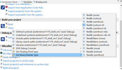

Hi @mimlo ,
Hope you are doing well!
Try configuring the IDE like this in the picture below:
And this thread may help you on this topic. Hope this helps!
Gavin

mimlo
Hi @Gavin_Jia ,
I did the following steps.
1.) Removed the shell project.
2.) Imported new one with default settings
3.) Set the MCU Linker flag as on your screen
4.) Set proper lib for build
5.) Compiled the project
It worked correctly. The possible reason behind my previous failure was this information prompt that show up when a user hovers mouse pointer over the lto linker option:
It does not work only if I do exactly as the message prompt suggests me to do.
If I understand it correctly, it does not take effect if it is enabled only in there. It must be enabled on the end as well, so even though that option allows for the project to compile, it does not take any effect I'm afraid
I think it could be corrected in some of the future MCU IDE releases if someone else if able to reproduce the issue.
Thanks for your help,
