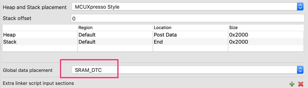

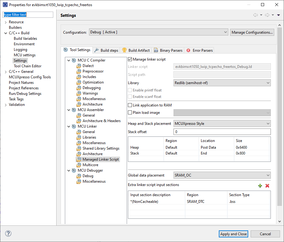

So I tried the solution of using AT_NONCACHEABLE_SECTION_ALIGN() macros to declare the Ethernet data buffers, but I found that they had no effect on the application.  After exploring what those macros do and examining the MAP files, I arrived at a complete solution.  (It's not the only possible solution, but it works for my application.)
Here is the definition for AT_NONCACHEABLE_SECTION_ALIGN() in fsl_common.h:
#define AT_NONCACHEABLE_SECTION(var) __attribute__((section("NonCacheable,\"aw\",%nobits @"))) var
#define AT_NONCACHEABLE_SECTION_ALIGN(var, alignbytes) \
    __attribute__((section("NonCacheable,\"aw\",%nobits @"))) var __attribute__((aligned(alignbytes)))‍‍‍‍‍‍
It simply declares the variable to belong to a section named "NonCacheable".  Importantly, the default linker script does absolutely nothing with this declaration; simply using this declaration will have no effect on the application.  I applied these macros to the Ethernet buffers:
err_t ethernetif0_init(struct netif *netif)
    static struct ethernetif ethernetif_0;
    AT_NONCACHEABLE_SECTION_ALIGN(static enet_rx_bd_struct_t rxBuffDescrip_0[ENET_RXBD_NUM], FSL_ENET_BUFF_ALIGNMENT);
    AT_NONCACHEABLE_SECTION_ALIGN(static enet_tx_bd_struct_t txBuffDescrip_0[ENET_TXBD_NUM], FSL_ENET_BUFF_ALIGNMENT);
    AT_NONCACHEABLE_SECTION_ALIGN(static rx_buffer_t rxDataBuff_0[ENET_RXBD_NUM], FSL_ENET_BUFF_ALIGNMENT);
    AT_NONCACHEABLE_SECTION_ALIGN(static tx_buffer_t txDataBuff_0[ENET_TXBD_NUM], FSL_ENET_BUFF_ALIGNMENT);
But they remained allocated to the same area of memory (SRAM_OC), and the application remained non-functional (app runs, but unit fails to respond to ping).
It is necessary to tell the linker to do something with regard to the "NonCacheable" section name.  In my case, I created a custom linker script input section, like this:
The entry there says that anything in section "NonCacheable" should be located in SRAM_DTC (by definition non-cacheable) and placed in the .bss section.  After making this change and recompiling, the application now works as expected.
This same solution can be applied to the MMC (and presumably SD) examples.  For MMC, edit fsl_mmc_host.c like so:
 * Variables
/*! @brief Card descriptor */
AT_NONCACHEABLE_SECTION(mmc_card_t g_mmc);‍‍‍‍‍‍
Then add the "NonCacheable" definition to the linker script as above, and now "g_mmc" is located in SRAM_DTC, while the remaining global data is in SRAM_OC as previously declared.
There may well be other means of declaring where "NonCacheable" data should go, but this seems the easiest to implement -- use SRAM_DTC for all non-cacheable data, and remaining global data can reside wherever (SRAM_OC, BOARD_SDRAM, etc).
It should now be NXP's task to re-test each of its SDK examples to ensure that there are no other cache issues in the SDK.  As Jack King has already identified, a caching issue exists with the USB examples.  Thanks for your assistance in resolving this matter.
David R.

25,174 Views
dmarks_ls
Senior Contributor II
Addendum: While declaring "mmc_card_t g_mmc" as non-cacheable allows the MMC driver to successfully retrieve the extended CSD information and thus initialize the card, the FatFS stack and demo code still fails to execute with data cache enabled.  These are my data declarations in my main program:
AT_NONCACHEABLE_SECTION(static FATFS g_fileSystem); /* File system object */
AT_NONCACHEABLE_SECTION(static FIL g_fileObject);   /* File object */
#define BUFFER_SIZE (100U)
AT_NONCACHEABLE_SECTION_ALIGN(uint8_t g_bufferWrite[SDK_SIZEALIGN(BUFFER_SIZE, SDMMC_DATA_BUFFER_ALIGN_CACHE)],
          MAX(SDMMC_DATA_BUFFER_ALIGN_CACHE, SDMMCHOST_DMA_BUFFER_ADDR_ALIGN));
AT_NONCACHEABLE_SECTION_ALIGN(uint8_t g_bufferRead[SDK_SIZEALIGN(BUFFER_SIZE, SDMMC_DATA_BUFFER_ALIGN_CACHE)],
So the working buffers that FatFS uses as well as the card struct should all be in non-cacheable memory, but something fails when the demo code tries to create a directory; the call to find_volume() returns FR_NO_FILESYSTEM because of a bad return value from check_fs().  So I'm going to have to keep data cache disabled until NXP completes their internal review of their RT1050 SDK code and drivers.
David R.

Further update: I have a diagnosis and a workaround, but I need you (NXP) to tell me what should be done differently to avoid requiring the workaround.
The issue is the data cache.  SRAM_DTC is not cached, and so if the global data (including the mmc_card_t struct) resides in SRAM_DTC, then the driver functions correctly.  If the global data is placed in SRAM_OC or BOARD_SDRAM (both cacheable by default), then the MMC_SendExtendedCsd() function fails to retrieve any data, meaning that card->rawExtendedCsd[] remains zero.  Thus, the driver later chokes because card->extendedCsd.cardType is zero.
The workaround is to call L1CACHE_DisableDCache() (from fsl_cache.h) during system startup.  Once the data cache is disabled, the above program (rt1050_emmc_sdram) successfully retrieves extended CSD data from the eMMC device.
By investigating this problem, I have also inadvertently solved another issue I was having, namely that the lwIP TCP/IP stack seemed to be inoperable when called from my main program, which uses SDRAM for global data.  After inserting the call to disable cache at startup, the TCP/IP stack now operates.
I have attached a project that demonstrates this failure.  This is the SDK example for the RT1050 for lwIP running on FreeRTOS with the tcpecho demo.  I have modified the linker configuration to use SRAM_OC for global data, and I have inserted a call to L1CACHE_DisableDCache() in the main program.  As uploaded, the program runs on an RT1050 EVKB.  If the call to L1CACHE_DisableDCache() is commented out, then the program will appear to initialize and run, but the unit will not respond to ping or tcpecho.
So... what am I as a developer doing wrong?  Or does the fault lie with the SDK drivers not properly managing the cacheability of their data structures?  Disabling the data cache is a considerable performance hit.  What's the correct way to solve this issue?

Maybe to add some context on why I am trying to use OCRAM in the first place, and maybe there is a better approach to avoid these landmines.
I have spent many, many hours tracking down issues that are caused by caching problems with the SDK components.  Most of them are still unresolved, and much like drodgers‌ I have to put a temporary workaround in place just to continue other work.
Our design will eventually use the IMXRT1062 which has an additional 512K of OCRAM.  It is my understanding that this can only be used as OCRAM, not DTCM blocks.
To use this additional RAM in the future, we are trying to master the use of OCRAM on the IMXRT1052 along with the MCUXpresso SDK, placing certain buffers into DTCM when required.
It would be very useful if NXP could provide a document or application note specifically for using the SDK with caching on the IMXRT series, giving examples on how to convert the SDK samples to use OCRAM for ENET, USB, FatFS, SDcard.
As it currently stands, the only clues are in the config files and SDK comments (and this forum) and it seems that even these don't create a complete picture of what needs to be done to successfully use OCRAM with the SDK components.

About  your attached modified [lwip_tcpecho] demo, please use below code to select non-cacheable memory range:
Make below change to set ENET data buffer memory location:
Original definition:(enet_ethernetif_kinetis.c)
    SDK_ALIGN(static rx_buffer_t rxDataBuff_0[ENET_RXBD_NUM], FSL_ENET_BUFF_ALIGNMENT);
    SDK_ALIGN(static tx_buffer_t txDataBuff_0[ENET_TXBD_NUM], FSL_ENET_BUFF_ALIGNMENT);
Change to:
