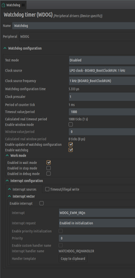

I'm having problems with the watchdog module. I don't know if it is the configuration or what is really happening. I added the watchdog peripheral driver and I have the following configuration for it:
The generated code for initializing it looks like this:
const wdog_config_t Watchdog_config = {
  .clockSource = kWDOG_LpoClockSource,
  .prescaler = kWDOG_ClockPrescalerDivide1,
  .timeoutValue = 1000UL,
  .enableWindowMode = false,
  .windowValue = 0UL,
  .enableUpdate = true,
  .enableWdog = true,
  .workMode = {
    .enableWait = true,
    .enableStop = false,
    .enableDebug = false
  .enableInterrupt = false
static void Watchdog_init(void) {
  /* WDOG peripheral initialization */
  WDOG_Init(WATCHDOG_PERIPHERAL, &Watchdog_config);
The code is executing that initialization correctly.

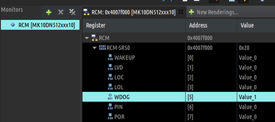

I let the code run and put a breakpoint inside the if (RCM_GetPreviousResetSources(RCM) & kRCM_SourceWdog) then after 1 second, which is my watchdog timeout, the execution hits my breakpoint despite calling WDOG_Refresh(WATCHDOG_PERIPHERAL); inside the while loop.

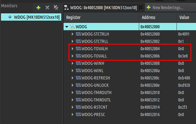

Also, I can verify that the watchdog timed out by looking at the peripheral view:
I also noticed that the watchdog value is not changing when running the code. It stays at 0x3e8 (1000) all the time.
But that doesn't make sense, shouldn't it be decrementing and then resetting the board when it reaches 0? Or does that register only holds the value that the watchdog timer references to?

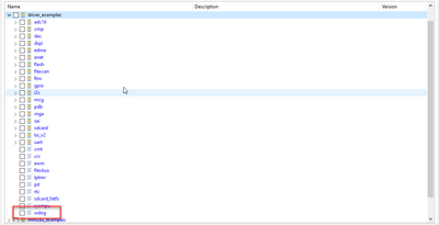

Only to check the module functionality, could you try the SDK example to check if this works correctly?
Alexis Andalon
3,229 Views
m4l490n
Contributor V
@Alexis_A thanks for helping!
The wdog example seems to be working but is confusing.

Alexis_A
Hello @m4l490n
You can found this API in the wdog example.
