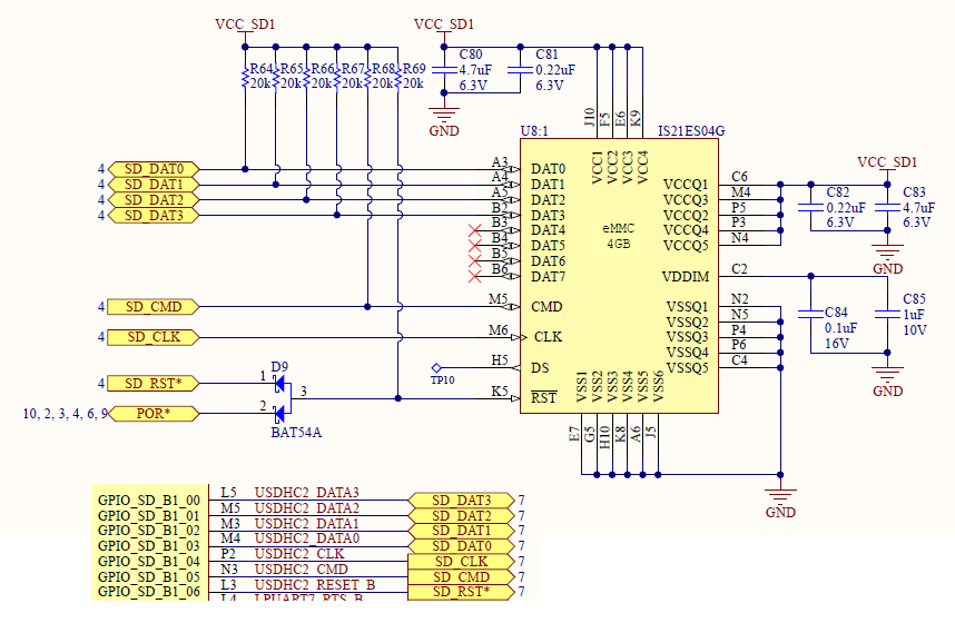

TL;DR -- When starting the MMC stack by calling mmc_disk_initialize() which calls MMC_Init(), a possibly incorrect switch() statement causes a subroutine to generate an assert().  (EDIT 9/16: The assert() occurs when the extended CSD data comes back all zeroes, and this occurs when a cacheable memory area, i.e. not SRAM_DTC, is used to store global data.  See discussion below.)
So I'm trying to get an eMMC device (ISSI IS21ES04G) to work on an RT1050-based board.  We have the device attached to GPIO_SD_B1_00-06 (USDHC2) in 4-bit mode.  Here's the schematic:

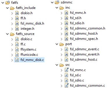

Since there's no SDK 2.6.1 example for an eMMC device, I instead took some files from the "fatfs_usdcard" example, cut out the SD-specific files, and imported MMC-specific source files directly from the SDK.  Here's what I have:
Of note, I deleted fsl_sd_disk.* and replaced them with fsl_mmc_disk.*.  I also customized my SDHC-specific board.h information:

I have not yet put a scope on the data/clk/cmd lines to verify there is activity; that'll probably be my next step.  My question is... what's going wrong here, exactly?  By the time execution reaches MMC_SelectBusTiming(), card->busTiming is set to 0 (kMMC_HighSpeedTimingNone) and the only flag set in card->flags is 0x100 (kMMC_SupportHighCapacityFlag).  So why does MMC_SwitchToHighSpeed() assume that either the bus width has already been selected to be 4-bit or 8-bit, or that HS26 or HS52 are already indicated in the card flags?  Has this code actually been tested on an MMC card?  What should I be doing differently?  Thanks.
David R.
