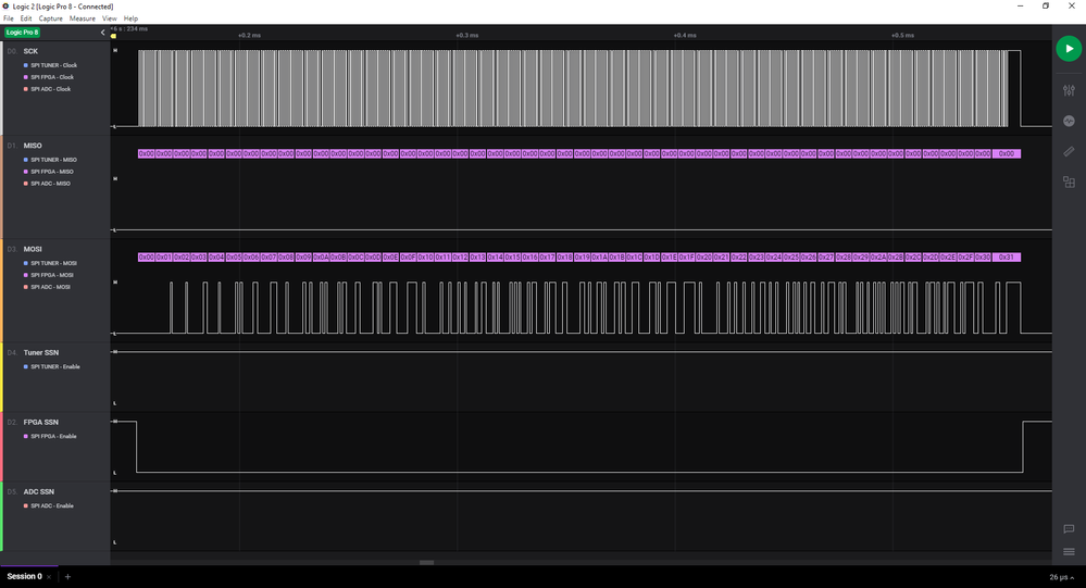

The code above works like a charm because it always writes the control bits. The result on the SPI output signals is
shown in the image blow.

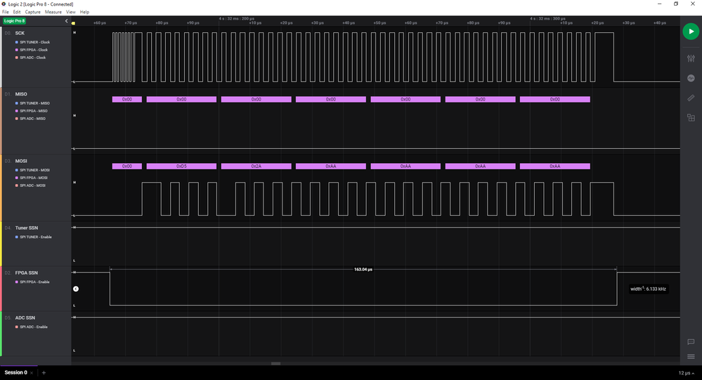

The control bits should not be modified if I am not mistaking and thus the result should be the same. Unfortunately I get an unexpected output signal on the SPI output.
The first byte is exchanged correctly but from the second byte the data is not correct anymore and even the clock speed seems to be changed which is totally unexpected to me because there is no option for this in the control bits.
I know I could always add the control bits and forget about the issue but I do not like to keep unexpected behavior in my code and forget about it I would like to know what I am doing wrong.

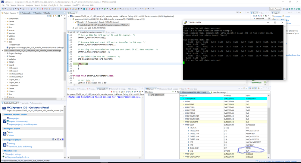

xiangjun_rong
Hi, Rik,
I have tested the SPI8 module with SPI master plus DMA with Byte transfer on MY LPC55S69-EVK, it is okay.
i copy the result here.
XiangJun Rong

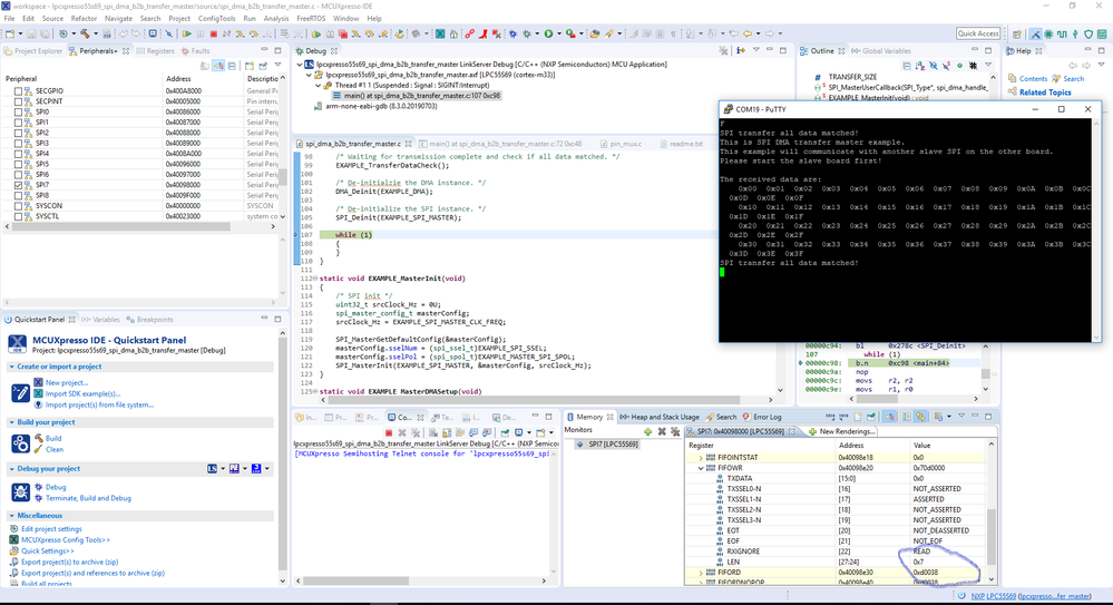

xiangjun_rong
Hi, Rik,
I just tested the lpcxpresso55s69_spi_dma_b2b_transfer_master project based on my lpc55s69-EVK board, I close the pin PIO0_19 to PIO0_20 with a resistor on the EVK, it works fine. As the following fig, the SPI transfer length is Byte.
Maybe our initialization code for SPI is incorrect somewhere.
XiangJun Rong

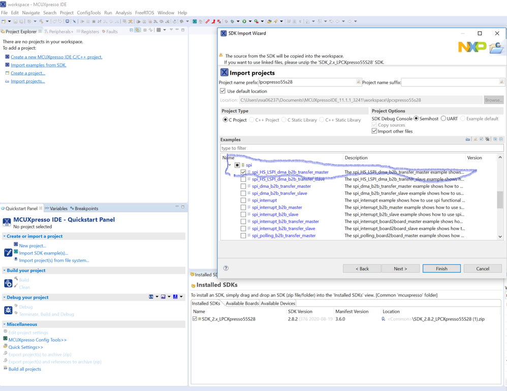

I have checked the SDK package, it has the example for both SPI plus DMA, it uses Byte transfer.
You can download SDK package from the link:
MCUXpresso SDK | Software Development for Kinetis, LPC, and i.MX MCUs | NXP
After you download the SDK package based on the LPC55S28, you can try to test the code.
anyway, pls have a try.

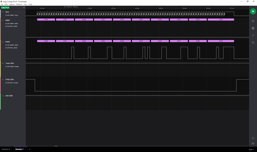

Unfortunately the result with the uint8_t transfer was as expected:
The word oriented transfer gave me the desired result:
While i did manage to create a successful SPI transfer on the high speed SPI port I do have the issue that is only works with the uint32_t/word oriented operations. To do this i have to copy all data from an byte array to a word array and add the configuration data to each word. Although i can communicate on high speeds this way it does impact the performance and memory usage a lot and this is totally undesired...

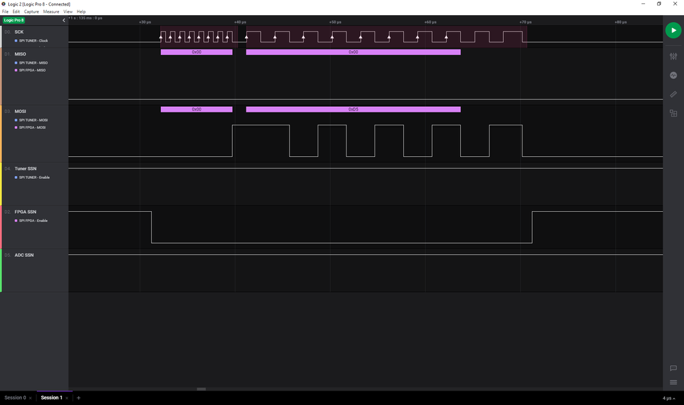

xiangjun_rong
Hi, Rik,
In the second figure, the SPI SCK clock changes it's period  during the transfer, I never see the phenomenon, it is abnormal.
For the writing  FIFOWR register code, I suggest you specify the data width.
For example
 ports[PORT].peripheral->FIFOWR = (uint16_t)in[txCount++];// + config;
Before the code, you have to set up the control halfword of FIFOWR with the data width, and TXSSELx.
Hope it can help you

It appears that you have to write all 32 bits data(control bits and data bits) to the FIFOWR register.
XiangJun Rong
