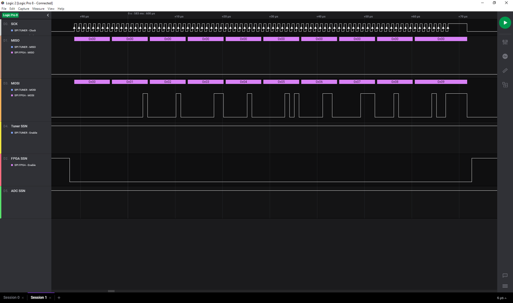

For the project I am working on we are using multiple SPI peripherals. I am currently working on a driver that meets up to our abstraction layer written in C++ but I encounter an issue when trying to exchange data on the SPI bus. All measurements are done on the LPC5528 processor and I use FlexComm8 for my SPI interface.
For the input of the exchangeBytes function i use the following data:
uint8_t dataTx[10];
 uint8_t dataRx[10];
 for(uint32_t i = 0; i < 10; i++)
 dataTx[i] = i;
 dataRx[i] = 0;
 System::spiFPGA.open();
 System::spiFPGA.exchangeBytes(dataTx, dataRx, 10);
 System::spiFPGA.close();‍‍‍‍‍‍‍‍‍‍‍‍
When I read the user manual for the SPI interfaces the FIFO write data register documentation describes:
Byte, half-word or word writes to FIFOWR will push the data and control bits into the FIFO.
Word writes with the upper half-word of 0, byte writes or half-word writes to FIFOWR will
push the data and the current control bits, into the FIFO. Word writes with a non-zero
upper half-word will modify the control bits before pushing them onto the stack.
The issue I encounter is the unexpected behavior when not always writing the control bits to the FIFO.
The code below shows the blocking exchange function code that is use and which results in a valid SPI transfer:

The code above works like a charm because it always writes the control bits. The result on the SPI output signals is
shown in the image blow.

The control bits should not be modified if I am not mistaking and thus the result should be the same. Unfortunately I get an unexpected output signal on the SPI output.
The first byte is exchanged correctly but from the second byte the data is not correct anymore and even the clock speed seems to be changed which is totally unexpected to me because there is no option for this in the control bits.
I know I could always add the control bits and forget about the issue but I do not like to keep unexpected behavior in my code and forget about it I would like to know what I am doing wrong.

Hello and thanks for the response, unfortunately i tried the casting already and without success. All data width 8, 16, and 32 bit writes give me the same result. I did try the casting to uint8 also but as expected the cast from the input parameter which is of the same type dit not result in a successful session. For the 32 bit word writ i changed the code to
uint32_t value = in[txCount++];
ports[PORT].peripheral->FIFOWR = value;‍‍
I validated with the debugger that the upper half word contains zero's. It seems like the peripheral doesn't take the current configuration bits with the new data.

It appears that you have to write all 32 bits data(control bits and data bits) to the FIFOWR register.
XiangJun Rong
7,931 Views
fruitmans
Ok so this is an issue inside the MCU? I think it should be mentioned in the errata sheet if this is the case.
How does this impact the functionality in combination with DMA?
