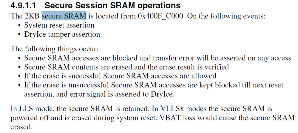

Can anybody suggest as to why I get hard fault error every time I try to access memory region 0x400FC000(Secure session SRAM) on a K81 processor? Is there any special initialization sequence that has to be performed prior to accessing this SRAM ? This SRAM is very vaguely described in the K81xxxx user manual.

   Can you kindly explain what you did? I am also facing issue to access Secure SRAM..

Please refer to below for how to access Secure Session SRAM , only two ways to access it.
