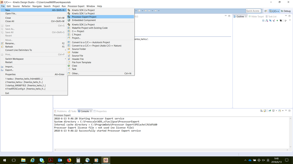

danielchen
Hi Angar:

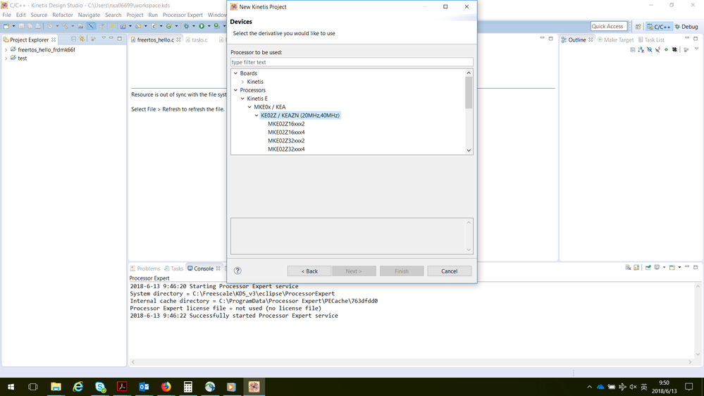

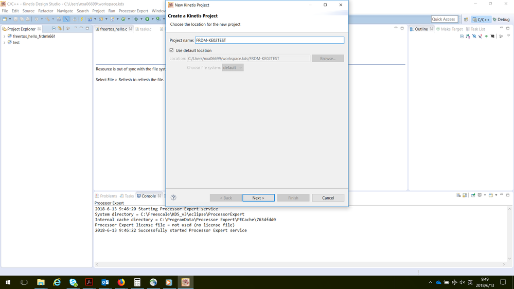

I assume you are using KDS.
Select your chips here
Next, Then you can get a simple project

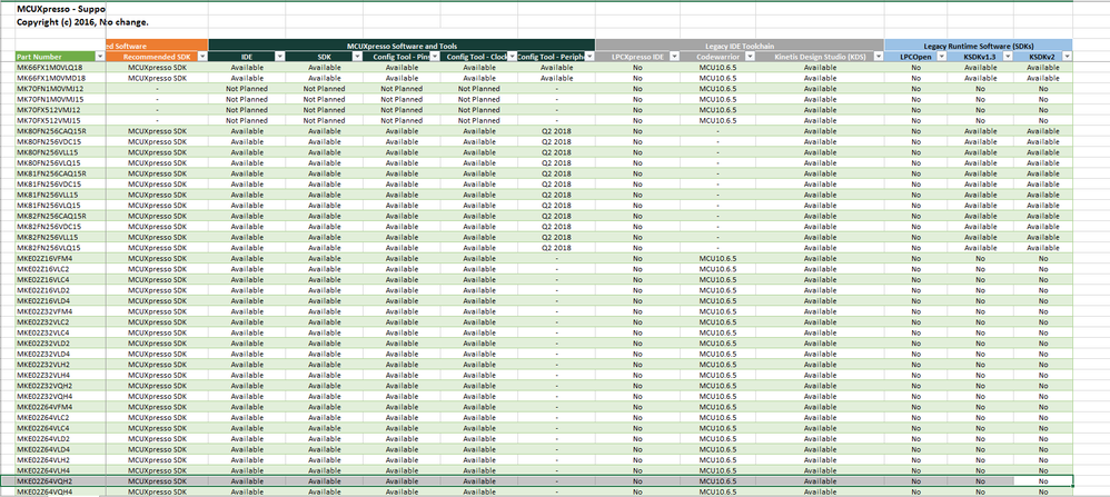

I'm using MCUXpresso. In the Future I'm going to develop a board which has MKE15Z256VLL7 (Which is not supported in KDS).
"MCUXpresso supported device table" says MKE02Z64VQH2's "MCUXpresso SDK" is available. That's why I got this board to get used to both hardware and it's developing environment. But now SDK builder doesn't have it's SDK. What do I do?NXP_pic.PNG
