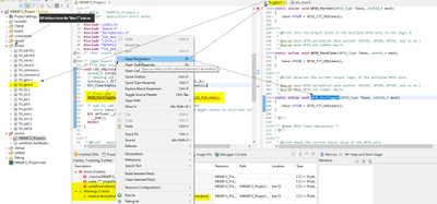

superaga
Hi Erich,
I have the same issue (undefined reference), but it appears to be slightly different...
I created a new project following an example from NXP. I made it from scratch with the help of the Configuration Tool.
All looks apparently good, since all folders have the blue C icon... but when I built the project it fails (see picture).
It is weird (to me) because if I select Open Declaration from the context menu on the statement that triggers the error, I can open that file, but the linker doesn't find it... (see attached Console output).
One more question: If the editor can find the referenced/pointed files doesn't mean that this is on the path isn't it?

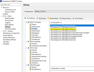

I tried to explore also the project properties, but also here looks fine:
Can you help me to understand this?
Many thanks!
Kind regards,
AGA
25,536 次查看
ErichStyger
Specialist I
Pay attention to the 'implicit parameter declaration' warning (this is actually more of a programming error, and I consider this as an error not a warning).
The issue is that you have missed to include "fsl_gpio.h" in MKF64F_project.c. That symbol is defined as inline function in that header file, and if you use that symbol without including it, it is not available and the linker rightfully complains.
PS: always check and fix warnings. I always try to keep my code warning free.

superaga
Hi Erich,
thanks for your help. That solved my error!
Since I generated the code using the Config Tool I though that all the drivers would have been added to main as well... This is a bit misleading... (drivers added to the project, but not included in the compilation..)
But in the end makes sense... The code is available, but not included until the user really needs it
It is my fault, since that error was triggered by the code I added.
And of course I'm completely agree about fixing all the warnings!
