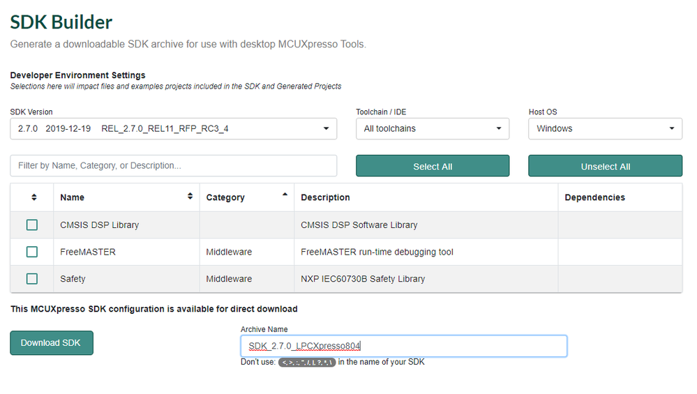

I'm a newbie as regards micro-controller programming and what I really want to learn is to use FreeRTOS on a microcontroller.
To begin with I have installed the MCUXpresso IDE (11.1)  and using the MCUXpresso SDK Builder I've created an SDK for the LPCXpresso804(LPC804). I've successfully installed this SDK into the MCUXpresso IDE.
From my reading of the NXP documentation I expected the SDK to contain the required code files to allow me to create a new project using the FreeRtos as the operating system for all Cortex 'M' controllers, in my case the LPC804..
From the 'Operating Systems' tab on the 'Configure the  Project' dialog of the MCUXpresso IDE there is only the option of 'baremetal'.
At this point I'm wondering if I have made an error when creating the SDK as I might have expected a configure project option to allow me to use RTOS as the operating system for the micro-controller.
I'd appreciate if somebody could comment on what I have done so far and in particular how to correctly create a SDK that will allow me to select FreeRTOS as the OS for the micro-controller.

FreeRTOS is not included in the SDK for the LPC804 (same for the LPC845 which I'm using in my projects (e.g. see “60 Billion Lights”: 2400 RGB LEDs and 120 Stepper Motors hiding behind Canvas Art | MCU on Eclipse  which uses 15 LPC845 running FreeRTOS). The LPC845 has more RAM, but 4 KByte is enough for running FreeRTOS (I have been using it on 1K RAM devices too).
So while it is not included in the SDK, it is easy to have it added to any SDK project. If this is of interest, let me know and I see if I can come up with a quick tutorial how to do this.

danielchen
Hi Ed:
There is no FreeRTOS support for LPC804 SDK.   You can only select CMSIS DSP library, FreeMASTER and safety components.   No FreeRTOS support in this list.
LPCXpresso804 only has 4KB RAM
5,678 次查看
edward_c_sewell
Hello Daniel,
Do you know what rule/criteria the SDK builder applies to decide whether FreeRTOS is added as an option or not to the SDK?
I suspect that the SDK Builder may be using the selected board's available RAM value as criteria. As a test I selected (at random) the board LPCXpresso51U68. This board has 96KB RAM
And here the optional FreeRTOS is available.
Ed
