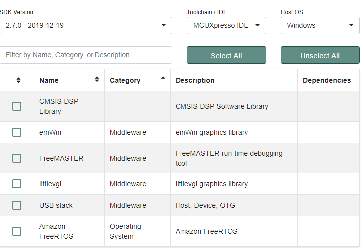

danielchen
Hi Ed:
There is no FreeRTOS support for LPC804 SDK.   You can only select CMSIS DSP library, FreeMASTER and safety components.   No FreeRTOS support in this list.
LPCXpresso804 only has 4KB RAM
5,616 Views

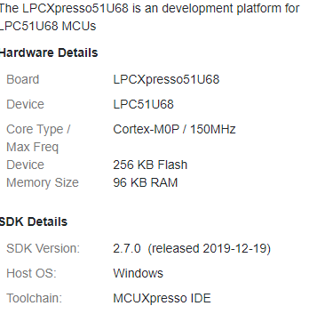

edward_c_sewell
Hello Daniel,
Do you know what rule/criteria the SDK builder applies to decide whether FreeRTOS is added as an option or not to the SDK?
I suspect that the SDK Builder may be using the selected board's available RAM value as criteria. As a test I selected (at random) the board LPCXpresso51U68. This board has 96KB RAM
And here the optional FreeRTOS is available.
