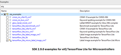

  2. Create new workspace and import SDK example – tensorflow_lite_micro_label_image_cm7 (all default settings)1_SDK290_eIQ_TFLMicro.png
    • Why this example? Because in newer SDK (2.10.0) there is a change in TensorFlow Lite for Microcontrollers library to version 2.4.1 (so it will be easy to check if updating SDK in current project is taken into account)3_change_log.PNG

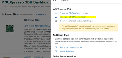

    • Change logs could be found in SDK_2_10_0_MIMXRT1170-EVK_doc.zip (you need to go online to your SDK dashboard and hit particular SDK, in my case SDK 2.10.0 as I am comparing SDK 2.9.0 vs 2.10.0 and then Download SDK Documentation)2_SDK_doc_change_logs.PNG

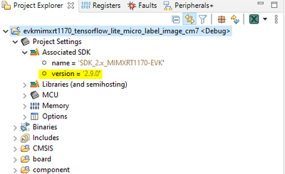

    • Current SDK associated with project you can check as shown below4_project_SDK_info.PNG

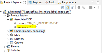

    • After changing SDK from 2.9.0 to 2.10.0, SDK associated with project is still 2.9.0 (seems fine as project has been imported from SDK 2.9.0)
    • What is interesting, when you restart now your MCUXpresso and check again SDK associated with project, version 2.9.0 changes to 2.10.0, however seems there are no important changes in project files (only in .cproject)5_project_SDK_info.PNG

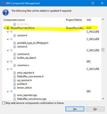

  6. Right click on project name -> SDK Management -> Refresh SDK Components and accept the incoming changes6_refresh_SDK_components.PNG
    • You will see popups as follows and seems it is up to you how you update these files (Replace, Keep existing or Compare)7_SDK_updating_questions.PNG

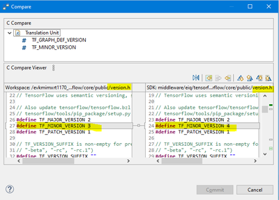

    • after few Replace clicks, you will see the question about version.h file and comparison looks like below8_SDK_updating_eiq_version.PNG
