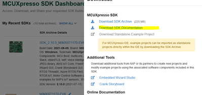

  1. MCUXpresso IDE v11.4.0 [Build 6224] [2021-07-15] and SDK_2.x_MIMXRT1170-EVK 2.9.0 (Stage 1013 2021-01-08) Manifest 3.8.0
  2. Create new workspace and import SDK example – tensorflow_lite_micro_label_image_cm7 (all default settings)1_SDK290_eIQ_TFLMicro.png
    • Why this example? Because in newer SDK (2.10.0) there is a change in TensorFlow Lite for Microcontrollers library to version 2.4.1 (so it will be easy to check if updating SDK in current project is taken into account)3_change_log.PNG
    • Change logs could be found in SDK_2_10_0_MIMXRT1170-EVK_doc.zip (you need to go online to your SDK dashboard and hit particular SDK, in my case SDK 2.10.0 as I am comparing SDK 2.9.0 vs 2.10.0 and then Download SDK Documentation)2_SDK_doc_change_logs.PNG
    • Current SDK associated with project you can check as shown below4_project_SDK_info.PNG
