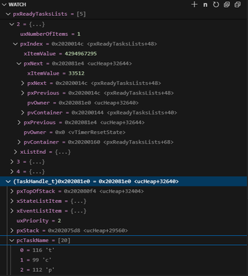

azarubkin
I'm getting FreeRTOS crash in the "wifi_setup" example imported from SDK.
Here's a tail of the debugging session output:
[New Thread 3]
[New Thread 9]
[New Thread 1610631818]
[New Thread 5]
[New Thread 6]
[New Thread 4]
[New Thread 8]
[New Thread 7]
[New Thread 10]
Thread
2 received signal SIGSTOP, Stopped (signal).
[Switching to Thread 3]
Reset_Handler () at C:/tmp/mcux_sdk_release_25_06_00/mcuxsdk/devices/RT/RT1060/MIMXRT1062/gcc\startup_MIMXRT1062.S:446
446	    b DefaultISR
The debugger shows the state of the threads. The top of the current thread call stack is:
"Tmr Svc": Stopped
Reset_Handler@0x60002524
<signal handler called>@0xfffffffd
If I look at pxReadyTasksLists array in the debugger, it shows that its 2nd element has uxNumberOfItems == 1 but pxIndex points to xListEnd. At the same time, xListEnd->pxNext and pxPrevious point to "tcp/ip" task. I've attached a screenshot.
My setup:
  • MIMXRT1060-EVKB board
  • MAYA-W161 M.2 Wi-Fi card
  • I have the resistors resoldered on the board to enable M.2 connector.
  • I'm using Visual Studio Code with MCUXpresso for VS Code extension
  • I've imported MCUXpresso SDK Repository version 25.03.00 (I've checked version 25.06.00 but it made no difference)
  • I've imported the following example from Repository: wifi_examples/wifi_setup, as a Freestanding application.
  • I've also made a wrapper for tcpip_input function to print something to the debug console.
As my Wi-Fi card isn't readily available in the choice of cards, I've made the following changes to the SDK sources:

My wrapper function looks as:
err_t wifi_tcpip_input_wrapper(struct pbuf *p, struct netif *netif)
    PRINTF("In wrapper\r\n");
    const err_t result = tcpip_input(p, netif);
    return result;
So there's nothing criminal there, just calling the original function. The crash happens after "In wrapper" is printed to the console, when the software should switch to "tcp/ip" task.
There's a similar post on FreeRTOS forum: https://forums.freertos.org/t/incorrect-pxreadytaskslists-state-causes-fault/17791, only in my case pxCurrentTCB is correct, pointing to "Tmr Svc" task.
The solution to that topic was an incorrect interrupt priority. I tried setting all NVIC->IPRn registers to 0xF0 at the beginning of the program to set all priorities to the lowest possible level but that didn't help. I also checked the stacks -- they are fine. I can attach my project or upload it anywhere if that helps.
If I don't use wrapper function, so that the SDK code calls tcpip_input directly, the example works but sometimes I get delays in ping responses of like 1600 ms which is strange because I ping my local router. So I suspect the bug is still there but adding a PRINTF makes it more apparent.

xPSR register value is 0x81000004.
4,080件の閲覧回数
azarubkin
If I run the project in MCUXpresso IDE with SDK 25.6.0, the execution hits MemManage_Handler, if that helps. In MCUXpresso for VS Code, it's DefaultISR instead of MemManage_Handler.
4,099件の閲覧回数

azarubkin
Have you tried building it in debug mode? I've found that the crash happens only in debug build. Also, setting
#define configTIMER_TASK_STACK_DEPTH (configMINIMAL_STACK_SIZE * 2)
fixes it in debug mode as well.
It appears stack overflow happens in timer task in debug mode. How do I calculate the amount of stack needed for the task?

azarubkin
For some reason, replacing tcpip_input with a simple wrapper leads to stack requirements growth in Tmr Svc thread.
4,036件の閲覧回数
azarubkin
Yes I am sure. I've imported the example from scratch, reverted most of my modifications to the SDK and selected MURATA-1XK-M2 board in the Kconfig GUI tool.
The only modification to the SDK is to call my wrapper function instead of tcpip_input:
