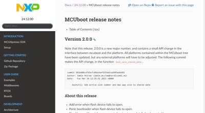

I'm using the iMXRT1021 MCU with MCUXpresso SDK 24.12.00 and MCUBoot as middelware component from SDK.
Is there a way to know which MCUBoot version is included with SDK?
I searched in code but no version is defined for MCUBoot...
Thanks!

Hi!
Just found in SDK documentation the MCUBoot Release Notes: it should be 2.0.0
MCUboot release notes — MCUXpresso SDK Documentation
