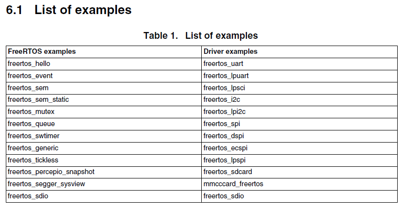

I recently downloaded the SDK v2.6 for the iMX RT1064 eval board (evkmimxrt1064).  The documentation file for FreeRTOS (Getting Started with MCUXpresso SDK and FreeRTOS OS.pdf) mentions in Table 1. List of Examples that there is an example project for "freertos_lpspi":

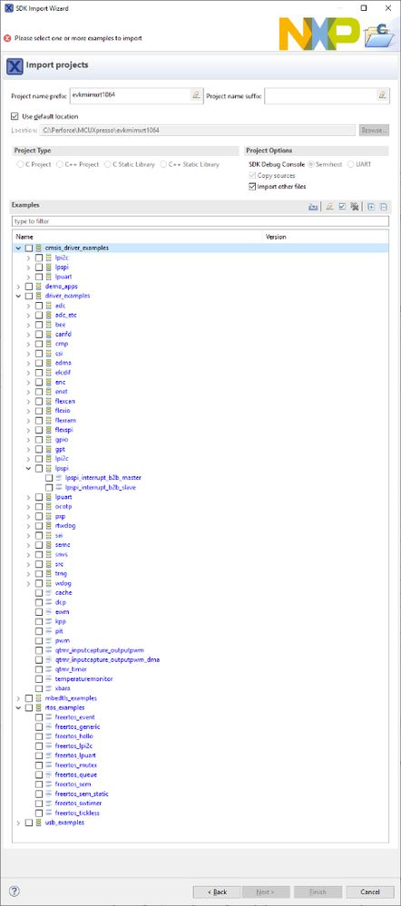

However, when I try to "Import SDK example(s)..." from MCUXpresso, this example is not listed under "rtos_examples" or "driver_examples>lpspi".
Any idea if the "freertos_lpspi" example actually exists, and if so where can I find it?

Could you please share a link of where did you find the document "Getting Started with MCUXpresso SDK and FreeRTOS OS.pdf"?
I checked on the previous versions of the SDK and the example freertos_lpspi was never included. Unfortunately, this example doesn't exist for the RT1064, sorry for the inconvenience that this might cause.

Hello Nick,
Thanks for the clarification. You are right, there's a mistake either with the documentation or with the SDK builder. I'm currently checking with the SDK team which one is wrong, I will let you know as soon as I have a response.

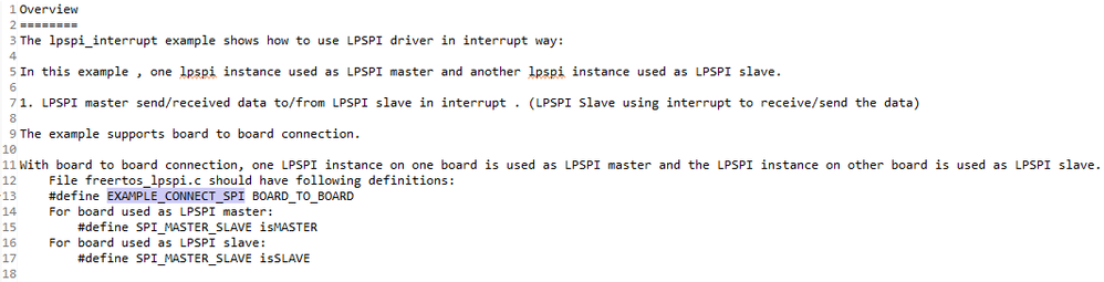

That is only partially true.  I have an RT1020 board that I had not used, but downloaded the SDK based on your earlier comments about LPSPI FreeRTOS example having been removed only for the RT106x boards.
Looking through the example code and the readme.txt in the doc folder there is an explanation on how to use the code as a single board with master and slave, master only or slave only:
This should have been included for the RT106x boards and would have been very helpful.  Alternatively, when purposefully removing example projects, state that with some sort of rationale.
