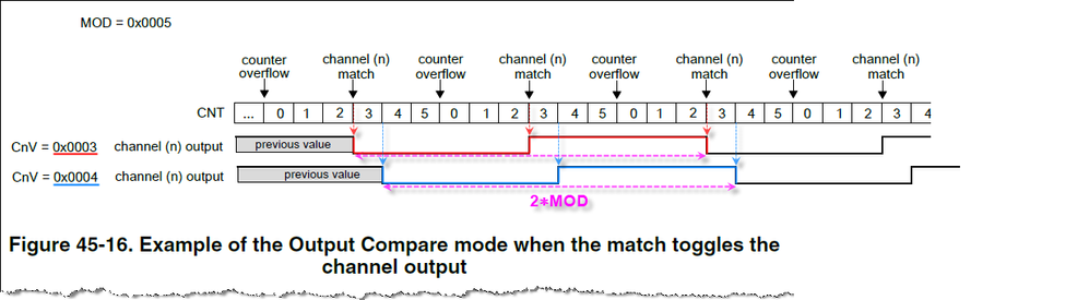

Q: Are you suggesting that this function doesn't work as advertised?
A: No. The channel output is changed based on what is specified in the compareMode argument, but it's hard to observe when you has only one channel.(The CnV only move the waveform, it can not change the frequency. The frequency is related to MOD, you need to use FTM_SetTimerPeriod change the frequency.)
You may need to add another channel and only modify one of them. Then you can observe the waveform move.

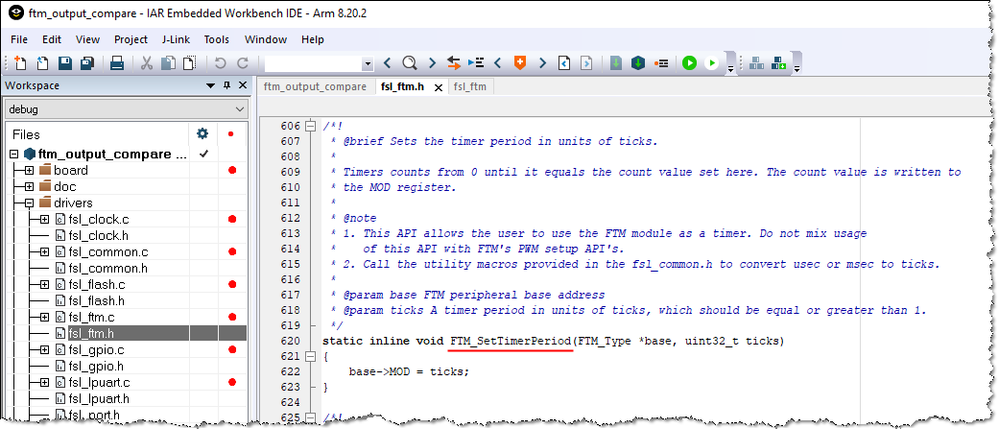

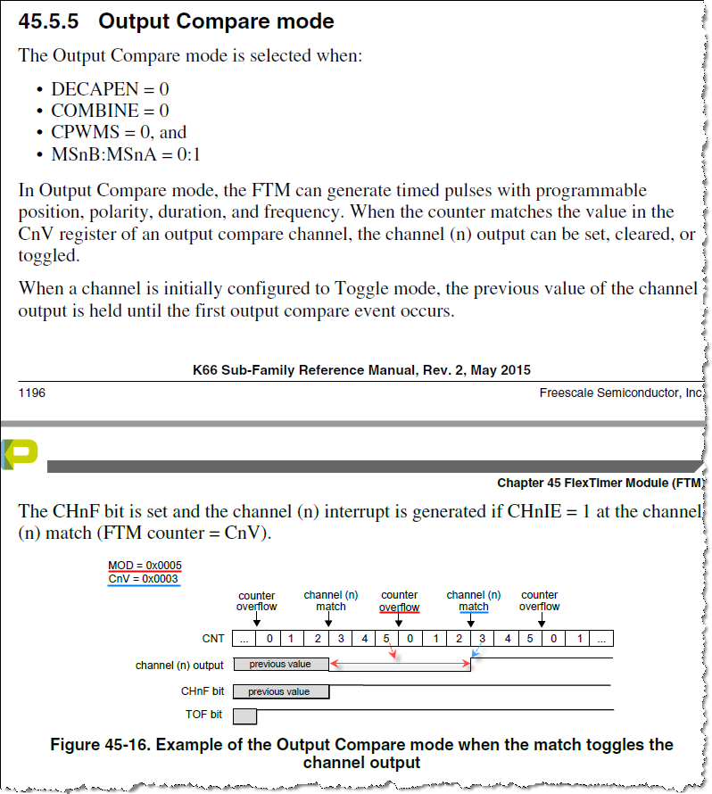

Robin_Shen
Please use FTM_SetTimerPeriod function change the frequency of the output.
The compare value is not used to do that.

wygonski
Robin,
Thanks for your reply.   The SDK demo program uses the FTM_SetupOutputCompare library function.  The MCUXpresso SDK API description states:
"When the FTM counter matches the value of compareVal argument (this is written into CnV reg), the channel output is changed based on what is specified in the compareMode argument."
When I change the value of the compareVal argument and re-build and run, there is no change in the output.  Are you suggesting that this function doesn't work as advertised?
John

wygonski
I modified my code to use the FTM_SetTimerPeriod() function and it works as you described.
Thanks for the clear and helpful answer.
