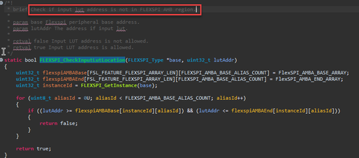

However, the parameter description of this in FLEXSPI_CheckInputLutLocation() states this:
* param lutAddr The address if input lut.
The function then checks that the lutAddr value is within the flexspi range, but if it is then it returns false rather than true.
It seems the check is either backward, or that the calling function is passing the wrong value (the new LUT source rather than the destination).

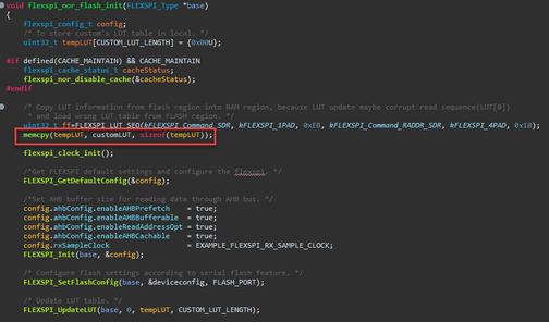

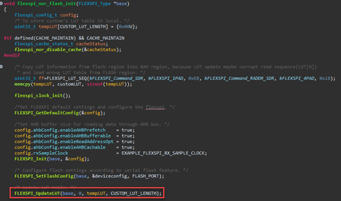

The function you are referring to is currently receiving an address, specifically, the address of the variable named tempLUT, as shown in the following image:
This variable, tempLUT, contains the LUT that was previously created:

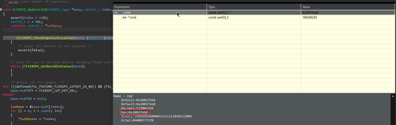

Inside the function FLEXSPI_UpdateLUT, there is a call to another function named FLEXSPI_CheckInputLutLocation, which takes as a parameter the memory address pointed to by the pointer. As mentioned earlier, this is the address of the tempLUT variable.
If we examine the cast operation, we can confirm that the address pointed to by cmd refers to a variable located in RAM:
Therefore, if the address passed as a parameter is not within the range of any FLASH memory, the function FLEXSPI_CheckInputLutLocation will return true.
This behavior is expected, as the purpose of this function is to verify that the LUT is not located in FLEXSPI AHB region.
